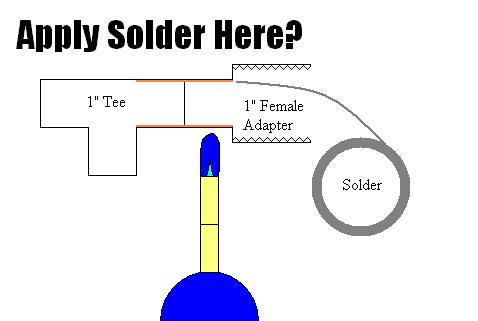

Thanks for the responses. I just bought the necessary copper fittings. Much to my dismay, they did not have a fitting where one end is 1" NPT, and the other end is 1" pipe (called a female fitting adapter; they do have them in 3/4"). It is basically a "street" female adapter. So I just bought a regular female adapter.
I like to have all of my fittings flush. This is easy to do with PVC cement. However, with solder, there needs to be a small gap for the solder to run into. My question is, can I solder something from the wrong side? Here is what I plan to do: I will heat up the female adapter fitting (Which will be sitting on top of the 1" pipe) regularly. When the copper pipe and fittings becomes hot enough, I will push the solder against the copper pipe, but instead of doing this on the exterior of the fitting and pipe, I hope to be able to apply the solder inside the female fittings. If this works properly, it will allow me to have a female adapter which will be flush with the tee it is soldered next to.
Sorry if my explanation is poor. I included a picture.

I can see you ending up with solder running down inside the pipe the piston needs to slide in. Just make them reasonably flush and give yourself some room to get the solder in the center joint. What's wrong with a small gap with a silver ring around it?
The street female adapters actually never seem to be as nice a fit as the pipe anyway and the interior is rarely as smooth. On some brands there is a bit of a lip at the middle which can hinder getting the piston in or out.

rmich732 wrote:Thanks for the responses. I just bought the necessary copper fittings. Much to my dismay, they did not have a fitting where one end is 1" NPT, and the other end is 1" pipe (called a female fitting adapter; they do have them in 3/4"). It is basically a "street" female adapter. So I just bought a regular female adapter.
When I do things like that, I usely leave a small section in between them so I can put the solder in there.

What if you soldered the pipe leaving a little gap, then after the solder runs in you pushed them together to get rid of the gap?

When I soldered the tee on my copper cannon, I started from the bottom. When I made "flush" connections, I just left a small, (3/4 mm), gap between the parts and did each separately. It worked fine for me. Also, for the front and back of the valve, I did the same thing. The only thing that caught me up really was soldering the bushing into the end of the tee. I soldered the 1/2" barrel into the bushing first, then soldered the bushing into the tee.
