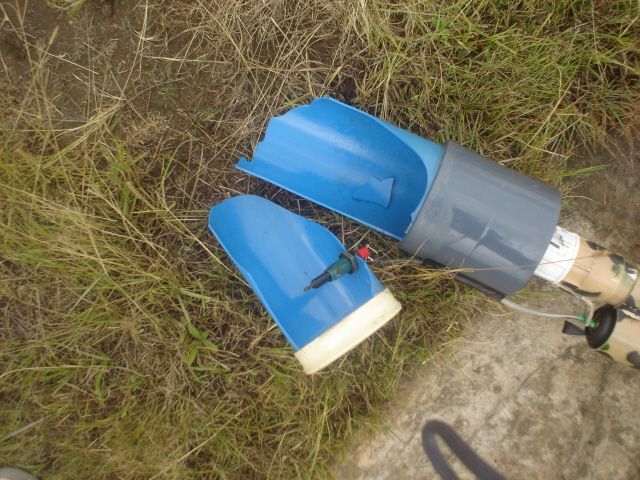

My Cousins combustions, chamber failed on him here the pics(He requested that i add them before he rebuilds it, as he doesnt have ADSL)
Pipe was pressure rated
DYI

That pipe doesn't look very sturdy. Also, with such a thin walled and obviously flimsy chamber, putting a hole in a single layer of pipe for the igniter wasn't a very good idea. This failure would seem to be the result of using materials of inadequate strength.

I agree. The pipe used looks way to thin to absorb shock. However if it is pressure rated I'm sure it wasn't shock rated which mean it would be able to hold pressure, just not in quick bursts. The ignitor is obviously the problem in this photo. The origin in the crack is traced diretly back to the ignitor.

what kind of pipe is that blue stuff? ive never seen it before

Its pipe we use in sa For irrigation, pump water from a dam up to a Orhid. Will find out what pipe

6 bar pipe, 85psi

and a closed combustion chamber produces 120...

yet i use normal drain pipe...I think.... No problems so far
