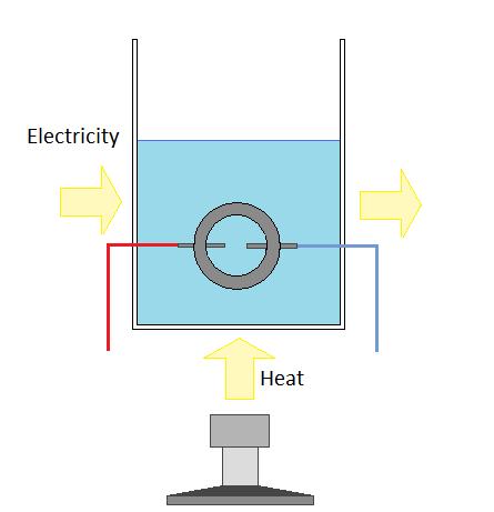

For no reason in particular, I wanted to design a way to make water boil faster. Thus, I came up with this idea:
Electricity produces a large amount of heat when it is not insulated, regulated, and etc. Therefore, running a bust of electricity through water should theoretically heat it up. Using this logic, I came to the conclusion that it you had a heat source under a body of water, and sent electricity through the water in a short burst, then the water will be quickly heated. Then, the heat source underneath the water would be able to keep the water at a steady temperature. See diagram 1.
So I have two questions:
1. Does this idea make sense? Is it plausible (not practical)?
2. If electricity is sent through a body of water, will the water still remain electrified or will the water eventually lose its charge?

- Diagram 1: Instantly boiling water
- Instant Boiling.jpg (13.77 KiB) Viewed 4664 times

no. What you are doing is called electrolysis. The electricity does not so much flow through the water, as cause it to separate into hydrogen and oxygen. If you did manage to pump enough current through to get it to arc, then you would flash boil the water, destroying your face.

Hmm, that makes sense. Indeed, I have seen the flaw in my design.
That being the case, does anybody else have a suggestion for a way to boil water rapidly?
