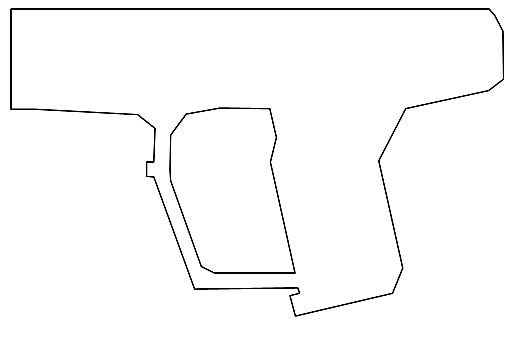

My son and I are making a Recon Armor costume from HALO3. He is going to be armed with a shotgun and a Magnum (and a Spartan Laser...). We are in the process of designing the Mag and the shotty.
I want to make both of the prop guns to have blowback. I originally explored solenoids but I couldn't find one that didn't feel wimpy when it actioned.
He and I were out back shooting cans with some of our CO2 guns and I realized that that might be just what we needed. One thing led to another and here I am at your forums.
So, I want to incorporate a blowback design into each weapon. The main things I'm looking for are a loud sound and real recoil. I do not need them to fire anything and, in fact, I'd rather not have it so that my son can figure out how to fire anything out of them (yet!).
I've attached a picture of the outline of the Magnum. I figure that whatever I put in the Mag will work in the shotty as well. For reference, the mag is about 10" long and a little over 1" wide at slide. I know that there is room in the grip for a 12oz CO2 cylinder.
So, with the above information, what would you guys recommend as the best way for me to get BANG and blowback? I am truly open to any and all ideas.

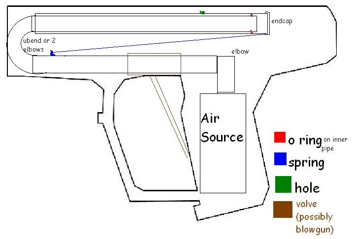

this design is something I drew up. when the valve is opened, the pressure pushes the outer pipe(and the part of the gun for blowback) back, until the equalization hole passes the o-ring, at which point the pressure releases and the spring pulls it back.
- i drew this into the outline provided
- blowback prop gun design.JPG (36.91 KiB) Viewed 17553 times
