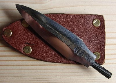

No, dont forgot it, its actually very easy to do. I can make a video of differential heat treating if you want

You did etch the blade did you?
Est Sularus Oth Mithas
I have etched it with a repeated hot cider vinegar bath, but I'm finding the oxidation of the edge in comparison to the back isn't extreme enough to produce a strong hamon.
Given this was my first attempt at the hamon, I suspect I would have had an easier time with a steel with less vanadium and manganese. It is functional, however.

Hmmm, sand the blade to 2000grit and LIGHTLY etch it, then it should be more visible

No no no no, perfekt polish and LIGHT etch, that is what you want. The etch is just for getting the hamon to look little darker, the polishing is to get is visible
