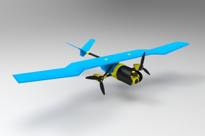

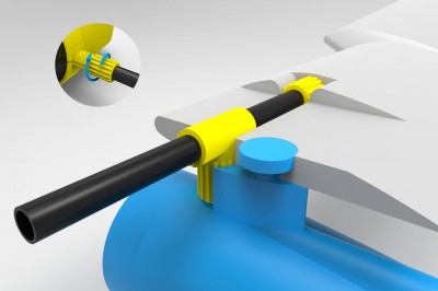

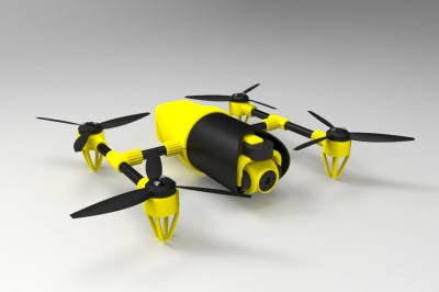

Doubt I'd ever build this, but some research later I found out 2h flight time drone is totally possible.
An idea I had, a modular drone that allows different configurations. Got the weight, size and main component figured out too, technically seems possible.
Been thanked: 352 times
I like the design, why the inverted gull wing on the fixed wing configuration though? There doesn't seem to be any practical benefit. I would have the wing in line with the motor nacelles to reduce drag, then maybe have a gull wing to increase stability.
wyz2285
Austria
Posts: 2390
Location: Porto, Portugal
Center of mass is too forward, need some wing to lift it but the propeller would hit it so...
The reason the wing is where it is now to me trying to keep maximum compatible parts.
Doesn't the faster air from the propellers increase lift?
https://en.wikipedia.org/wiki/Antonov_An-72
wyz2285
Austria
Posts: 2390
That I'll only know if I ever build this, made the wing basically following the center of mass is where the first 1/3 if the wing is, as a glider.
