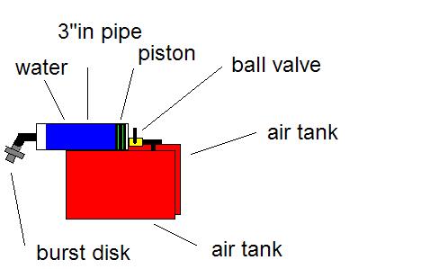

Anyway... I tested it today and ragnorak you were partially right, it got about 20 feet on its own, but about three with me riding it. But, the good news is that I learned from this, and I haven't invested to much money in this idea...yet.... Anyway I've thought up some new plans as seen below. It is basicly two of those 5 gallon portable air tanks, fitted together into one 3/4" ball valve. After that the ball valve is threaded into about 4 feet of 3in pipe. Inside the pipe there is a piston and on the other side there is water. At the end of the 3in pipe there is a 1/2' in burst disk. Will it work?
(plans below, everything is a view from the outside, except for the pipe which shows the working inside)

I think it might work but I would make the three inch pipe holding the water even longer I would do 6 or 7 feet instead of four because you have such a large air supply and you will want to use all the pressure store in the tanks dont angle the pipe leadind to the burst disk and use a .25 burst disk instead of a .5 one if you do all those things it might work
but it probably wont but if it does tell me and I will make one. But I wouldnt dump 100$ on something that probably wont work make it if you want but I dont recomend it.
