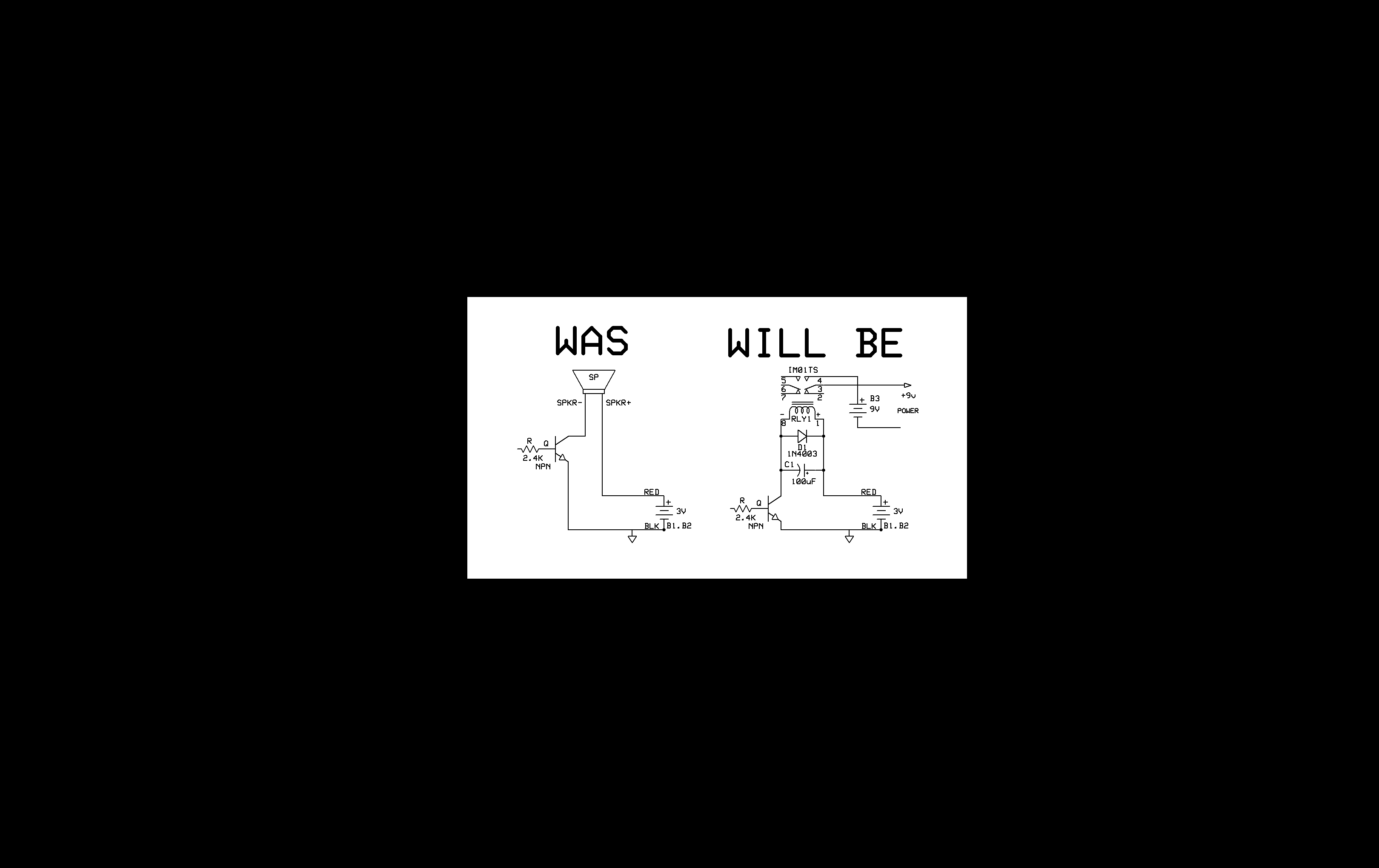

Here is a preliminary schematic for you understand or maybe confuse you.

Think I got the jist of it
Diode, capacitor and relay added to basket, proceeding to check out
Thanks.

MrCrowley,
You might want to take a look at the following link, in particular the first circuit shown on the page.
http://www.the12volt.com/relays/page5.asp
For things similar to this I prefer to use the following kit:
http://www.jaycar.com.au/productView.asp?ID=KA1732
Hope this helps.

Okay so I wired everything up but the relay seems to be normally closed in that it disconnects when I activate the relay. I realise I said "normally closed" in my topic post but I was thinking in terms of valves
Apparently to reset the relay you reverse the polarity but that doesn't seem to make a difference, it's still powering the circuit until the relay is triggered.
Ah so maybe this is a normally closed relay because moving the 'power' wire for contact 2 to contact 4 turns the relay on and completes the circuit when activated. According to the spec .pdf, this is how it should work.
So Dewey, did I confuse you by asking for a "normally closed" relay when I really needed a normally open relay? If so, sorry about that. Looks like I can still use the relay at least

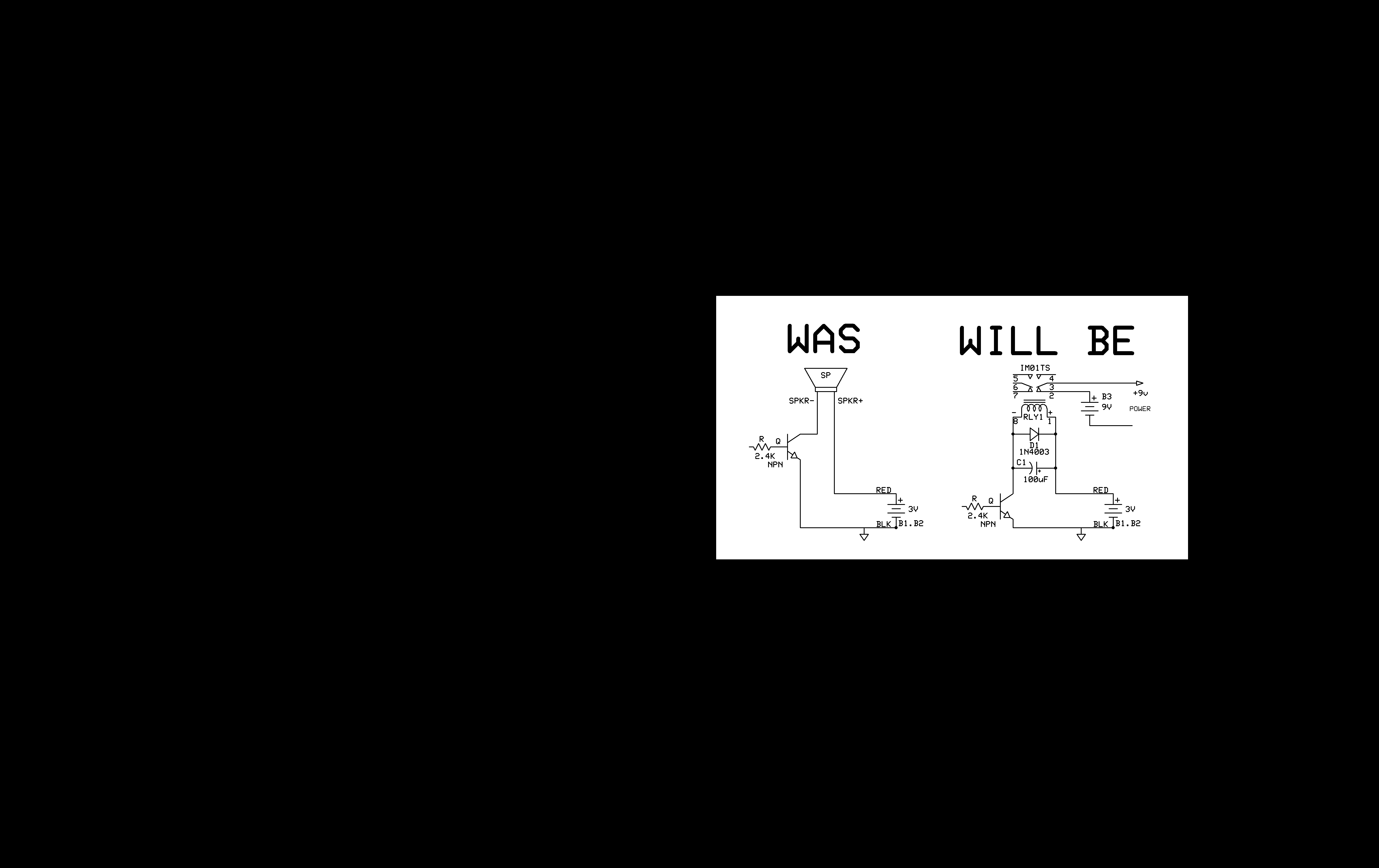

I was wondering why you wanted NC rather than NO.
Just drew what you wanted!
Here is revised to NO.
