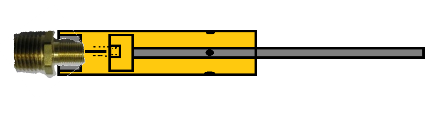

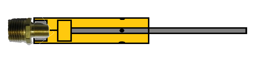

Edit, I thought of a good idea! Like the diagram that JSR originally posted, the piston itself hits a valve at the top of it's stroke and injects the high pressure air into the cylinder. At the end of it's stroke, the piston passes the exhaust ports (4) and can now freely move back and start the cycle over again. My question is, do you guys thing the schrader will have enough flow to push the piston? My concern is that the piston will not push the stem for a long enough period of time and barely any pressure will get in the cylinder. To ammend this, a spring can be added to the pin that pushes the schrader pin, allowing the schrader to be open for a longer time.
Hopefully on the one with the spring, the spring loaded pin will hold the pin long enough for a lot of high pressure air to enter the cylinder and make a more powerful engine.
Edit 2, if I take the spring out of the schrader, it will be easier for the piston to open it. But will the schrader close without it? Taking the spring out will increase the dwell time, which is good, but it needs to close before the piston turns around. I'm fairly certain it would, but I'm asking for assurance on this? Thanks.

That might work. I am no expert on the workings of air motors, but that looks like it will work. Just figure out how to get it going. Another thing you can do, use a pop off valve, but extend the stem on it that connects to the pull ring on it, and attach a piston to it. That might work, I don't know. If I see a lawn mower engine though I am going to try converting it to air power.

Hey Warhead, that's not a bad idea. But, it requires another bend on the crank shaft, and I'm trying to keep it down to just one. Plus, a pop off valve would be harder to open. But, still its a good idea. See my edits in the above post.

The spring inside of schrader valve is rather strong for this, and the flow isn't incredible, but might be passable. I suggest purchasing a check valve from McMaster and using that in lieu of a schrader. They have rather good flow, and a very weak spring holding the valve shut. Should work pretty well.

Saefroch, I don't really want to buy a check valve for this. I think with a small enough bore, the schrader valve will have enough flow.
