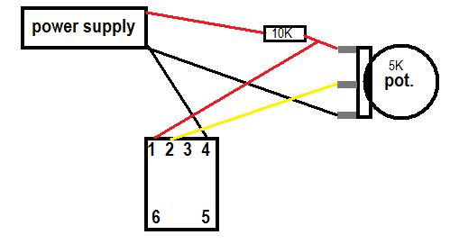

Hi Tech,
I tried wiring it up but I think I haven't followed your instructions correctly. As per the diagram below, I was measuring about 2.5V on a voltmeter at terminals 5 and 6 and less than 3mA. The readings didn't seem to change much when the pot. was turned back and forth.
On the other hand, if I connected terminal 1 straight to the power supply instead of after the resistor (as in the diagram below), I measured about 12.5V and ~350mA that could be adjusted from about 50mA up to 350mA with the pot.
I can't work out what I'm doing wrong but I have a feeling you'll know the answer.
- Sorry about the unprofessional circuit diagram, I'm hopeless at drawing proper circuits.
- circuit.jpg (15.46 KiB) Viewed 2075 times
Pin of 1 of the module has to go to power supply plus not the pot as you have it drawn.
That is what Tech stated.
- Technician1002
- Posts: 5189
It is a current regulator, not a voltage regulator. When a load is connected, the voltage the diode uses will be supplied as an open load will provide supply voltage.
This module can drive several LED's in series. If you use one that runs at ~3 volts at 300 ma, it will run at ~3 Volts. If two are connected in series, it will still provide regulated 300 ma but at ~6 Volts. this is how a current regulator works. You set the current.
A voltage regulator holds the voltage whether you draw 5 mA or 500 mA. A current regulator provides a set current such as 300mA whether at 2 Volts or 8 Volts.
If you want to test a module, use a 10 ohm 10 watt resistor. At 300 mA it will have 3 Volts on it.

Tech, can I ask for a basic circuit diagram?Technician1002 wrote:It is a current regulator, not a voltage regulator. When a load is connected, the voltage the diode uses will be supplied as an open load will provide supply voltage.
I tried hooking up a spare LED assuming it would only draw 3v or whatever like you said, but to no surprise it blew as it was receiving 12v. Surely there must be a resistor somewhere in the circuit or something that stops the LED from being blown.
Edit:
If anyone can make a circuit diagram for this it would be much appreciated. It's simply not working the way it's supposed to judging by what you guys have said about the circuit. Even my dad who knows a fair bit about electronics can't figure it out. I appreciate your help Tech but we cannot understand what you're saying without a circuit diagram and my dad is confused by the circuit diagram in the PDF at the top of page 3 which doesn't show the potentiometer in the circuit and has two resistors (6.8k and 15k).
I'll try and drop by Jaycar next week and ask them for assistance as well.
- Technician1002
- Posts: 5189
The diagram in the PDF is for using a 0-10 volt control. The two resistors shown simply divide the 0-10 volt control signal down to 0-4 volts on the module. If you fed +10 volts as shown and replace the 6.8K resistor with a pot to sweep from 0-4 volts that would work also. Since we are not using 10 volt control signal, using the supply 12 volts instead I gave values that are actually sold for a replacement control. (you can buy a 5K pot, but not a 6.8K pot) A fixed resitor to 12 volts instead of 0-10 volts is used. Instead of the second 6.8K fixed resistor, a pot is placed there to feed 0-4 volts to the control pin.
0-10 volt control is used in many lighting systems. The PDF shows the example circuit to interface with a 0-10 volt dimmer console. This is mostly obsolete as DMX-512 is the new control standard. DMX to 0-10 is sometimes used to control other lighting systems such as LED lights.
Give me some time to find a current limiter online so I don't have to try to draw one.
Edit. Found a basic current regulator. They work by functioning as a low voltage regulator with a fixed resistor load. In the image below, the shown LED can be between the transistor and ground as a current regulator can be placed anywhere in a series circuit.
This one is not adjustable as it uses a fixed resistor with a fixed voltage on it to set the current. Adjustable regulators often have and additional comparator circuit such as a second transistor or op amp to make the voltage applied to the resistor adjustable thus adjusting the current.
