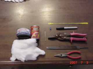

The materials needed:Tomato paste can,Tuna can,cotton balls or batting,permanent marker,thumb tack,nail,tin snips,hacksaw blade,and needle nose pliers

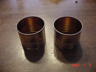

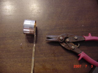

Empty out the tomato paste can and cut it in half with the hacksaw blade.You can file down the cut edge to make sure you don't cut yourself.

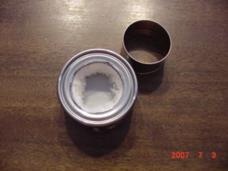

The tomato can half.Setup to trace around with the black marker.This will help you later when smoothing out the edges.

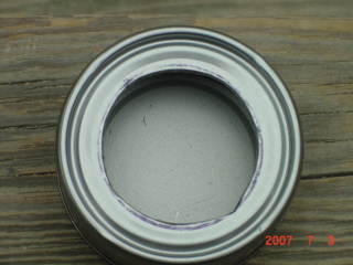

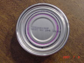

The drawn out lines.The black is where the can will fit and the pink is on a ridge closest to the black line.You will punch your holes on the pink line

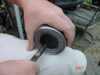

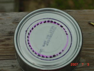

The process of punching the holes.The nail used needs to be sharpened.I used a flat Bastard file for this.The nail was then sharpened to a chisel point.

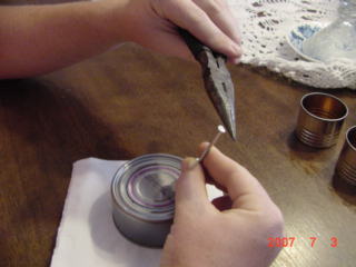

Use the filed nail and the needle nose pliers to punch a series of holes around the pink line.The holes should be close together so that the area in the middle can be taken out.

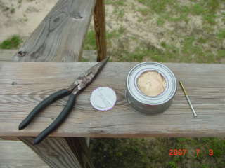

When you are done punching the holes take the cutout out with the pliers.Next empty and clean the can of all tuna.

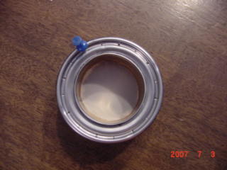

After rolling the edge of the tuna can it should now be smooth.The inner can should fit very tightly in this hole.The tighter the better for a seal.Check often to make sure the hole isn't too big.Continue until the can fits perfectly.

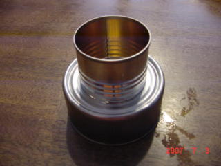

If need be trim the inner can down so that the top rim is sitting flush on the tuna can top and the bottom of the inner can is also flush on the bottom.
