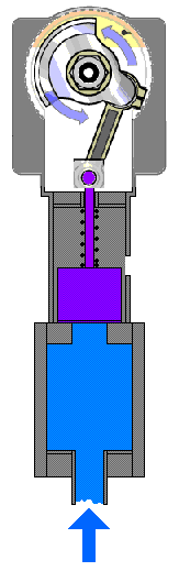

Ah ok. So it pretty much has a check valve built in?
Gun Freak
Lieutenant 5
Lieutenant 5
Posts: 4971
Sat Jul 30, 2011 10:36 am
Mine does, yes, but not the one in the video I posted.
Saefroch, I don't know if you saw my edit, but I plan to take the spring out of the schrader so it is easy to open.
Should I put a spring in front of the piston or will the crank shaft take care of that?

Sorry, must have missed that edit, or just not read the post :roll:. I've never taken the spring out of a schrader valve, so I don't know how difficult they are to compress without it.
Gun Freak
Lieutenant 5
Lieutenant 5
Posts: 4971
Sat Jul 30, 2011 1:48 pm
Oh, jack... :D
Saefroch, I took out the spring and it's loose, there is no tension and even with pressure behind the stem it is very easy to push. I think it will work.

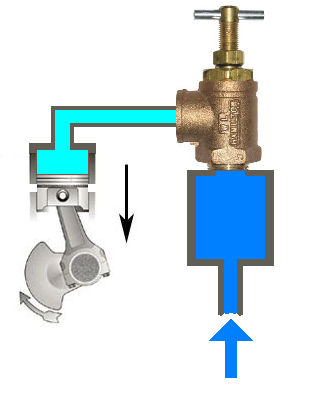

Gunfreak, unless you're using high pressure, I would suggest a much larger piston head.
A pressure relief valve could be used to drive the piston...

How would the air supply cut off on when the piston is on the upstroke?
Sat Jul 30, 2011 4:31 pm
the piston exposes the vents -> pressure drops -> pop-off valve closes
I don't like that design - too many variables that have to be tweaked

Poland, right, I wasn't thinking that that valve popped open. Sorry, I get it now.

POLAND_SPUD wrote:I don't like that design - too many variables that have to be tweaked
How about this, the pop-off piston is the actual piston. The piston is loose in the cylinder in order to stop it hanging.
