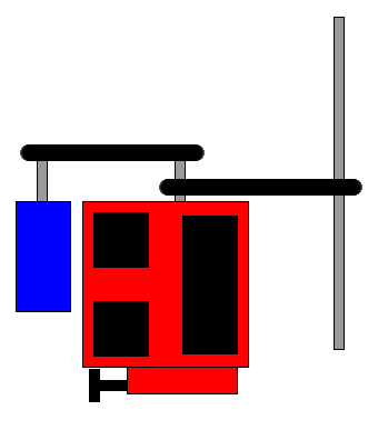

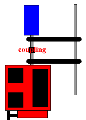

is it possible to get a small sprocket on to the engine, but on the clutch the other way so there is room, hook the 2nd sprocket to a car starter motor, and have some sort of electronic ignition? or even a hybrid go kart?
- saladtossser
- Posts: 1234
- Location: Toronto
electric start:
electric start and hybrid:
blue is electric motor
red is gas engine
the coupling in the second pic is flexible and removeable with a allen wrench
red is gas engine
- jrrdw
- Posts: 6572
- Location: Maryland
- Has thanked: 39 times
- Been thanked: 22 times
Being as how all car/lawnmower starters have slide out bendex style drives they wont work for what you have in mind. You have a new enough engine, that there should all ready be starter bolt holes on the side of the block, there should be a little removeable plug type gaurd on the flywheel backing plate held in by a little screw, (phillips head). Heres the thing your engine has to have a ring gear on the flywheel, if your engine has all of these things it will be easy to put a starter on, if not it will be exspensive to do. If you want to use a electric motor it will be hard to find one strong enough to start your engine, i would not modifie your clutch in any way what so ever nomatter what! Because it's easyer to just pull start it, and a lot cheeper. I know i didn't give you quit the answer your looking for but it's really the best i can say/do for you in this situation, some things just can't really be done.
