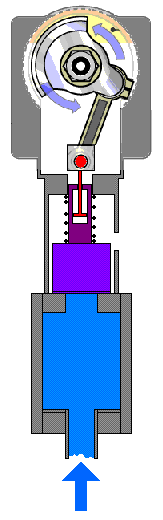

Makes sense... But I don't understand how that pop off piston pops. Is it the stepped piston concept?
Yes...Gun Freak wrote:Is it the stepped piston concept?

naaahhh somehow I don't see it workingHow about this
what's wrong with the one with a hammer valve ?
- Staff Sergeant 3
- Posts: 1769
Thats what my idea was. And the other one with the air pressure pushing down the piston, and a relief hole to let the pressure out so it can continue cycling.jackssmirkingrevenge wrote:How about this, the pop-off piston is the actual piston. The piston is loose in the cylinder in order to stop it hanging.POLAND_SPUD wrote:I don't like that design - too many variables that have to be tweaked

You make me sound like an idiot lol. Im sticking with my original ideajackssmirkingrevenge wrote:Yes...Gun Freak wrote:Is it the stepped piston concept?
If it doesn't, it was warhead's ideaPOLAND_SPUD wrote:naaahhh somehow I don't see it working
I just confirmed your interpretation of the design was correctYou make me sound like an idiot lol

Ramses, it is vented at the end of the extention stroke.
Jimmy, I am going to put a fly wheel of course.
I'm not big on ICs, so I don't know. Air is injected every time the piston returns.
I realize that. But doesn't air continue to flow while the piston is on the return stroke? The initial air is vented, but would build up again once the piston closes the port.Gun Freak wrote:Ramses, it is vented at the end of the extention stroke.
But if that builds enough pressure to do significant work on the flywheel while expanding, doesn't it build enough pressure when compressing to hang?

Personally I don like the design lol but in theory it relies on popping to move, not an airtight seal.
The port would have been closed by the spring, what the diagram should show is a telescoping coupling between piston and crank that will allow the shaft to turn while the piston is locked. Yes, twas a quick concept before Sunday night BBQramses wrote:But if that builds enough pressure to do significant work on the flywheel while expanding, doesn't it build enough pressure when compressing to hang?
This should work better:
- popoffenginemod.png (10.23 KiB) Viewed 2275 times
