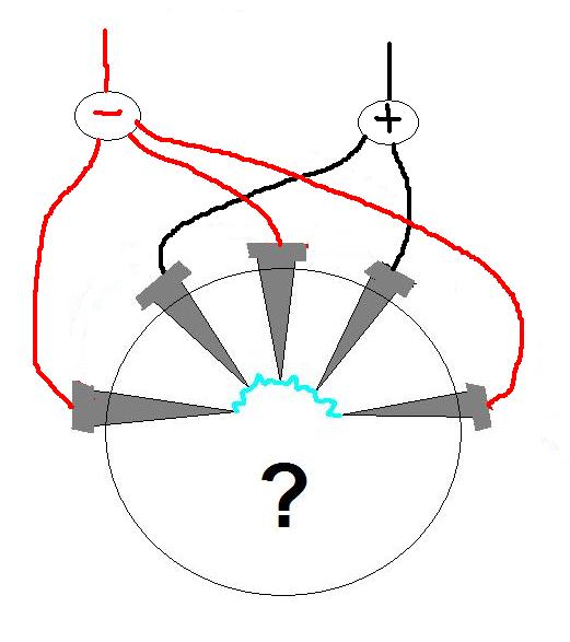

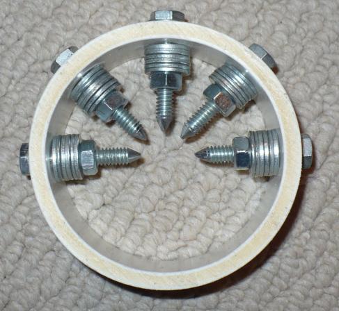

I made a spark gap system that will be running off a 100k volt stun gun (which i have yet to buy from bcarms) and was wondering if the system would work at 1x fuel mixture. Its for an advanced combustion so I don't plan on taking it past 1x...
the gaps are 1/8" apart (each) to the nearest mm.
I also grinded the ends to points for better conductivity.
I used 3" pvc but with the bolt heads on the outside, it fits snugly into a 4" chamber. Hope ya'll can help.
thanks in advance,
STHORNE
picture of the actual system
Here is a diagram of how i plan to wire the system.

You'll only get one spark out of that system, as electric currents follow the path of least resistance. In this case, it should spark between the rightmost point, and the one beside it, unless the gap lengths are off.

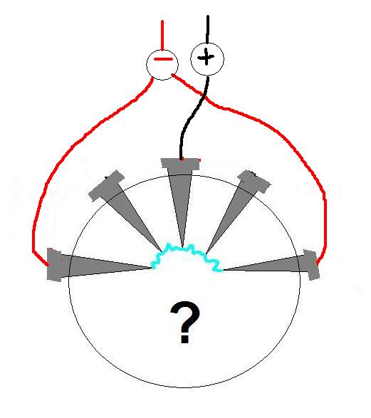

ok...i got another pic for you that i think might work...hang on...
STHORNE
Posts: 1208
Location: Kewaunee, Wisconsin
Thu Apr 17, 2008 7:21 pm
all being the same length in wire....

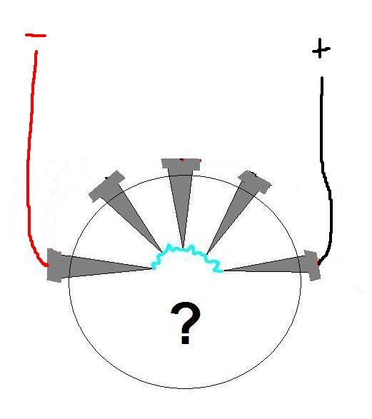

One wire will ALWAYS be shorter than the other, and a current can only follow one path at a time. The gaps have to be in series to work properly.

oh, ok...i think i got it...
got it...
1) would have to work unless the total distance between all bolts is too much.
2) I'm pretty sure it would work (or atleast one side would)

#1 will work, and one half of #2 will work.

since the tips are sharp, theylle corrode sooner or later, making the gap too big.

Even if it Doesn't work it sure is pretty.

The setup is flawed from the start. You would be better off taking the 3 in the middle out and just bringing the 2 outside points closer together with longer screws.
The other option is to take the middle one out and connect the 2 remaining middle screws together and the spark source connected to the outside screws. That would give you 2 spark gaps in series with each other. However, it would then be best to move the second gap down further into the chamber, splitting the chamber into thirds with the 2 gaps being the dividers.
Also, the big washer stacks aren't necessary unless you just like how they look.

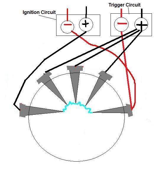

This seems like a good thread for me to help on. These knids of spark gaps are used on tesla coils alot. There is no real benefit to having multiple gaps set up the way you do. The only reason tesla coils have it is so the gap doesn't power arc due to a build up of corona and ozone. A greater surface area is easier to "quench" with a fan making it possible to fire a spark gap at higher frequencies. Another use, which I want to try myself in the future is remote triggering. Remote triggering uses a HV trigger circuit to add to the ignition circuit making a HV jump on cue. I'll put up a diagram to show what I mean by this. But, essentially, having a gap setup like that doesn't benifit much from only one power source, if any.
This is the remote trigger circuit. (A crude one anyway.) The trigger could be something like a bbq ignitor or a camera flash circuit. The ignition circuit can be any continuous HV source as long as it can't jump the distance alone.

rcman50166 wrote:This seems like a good thread for me to help on. These knids of spark gaps are used on tesla coils alot. There is no real benefit to having multiple gaps set up the way you do. The only reason tesla coils have it is so the gap doesn't power arc due to a build up of corona and ozone. A greater surface area is easier to "quench" with a fan making it possible to fire a spark gap at higher frequencies. Another use, which I want to try myself in the future is remote triggering. Remote triggering uses a HV trigger circuit to add to the ignition circuit making a HV jump on cue. I'll put up a diagram to show what I mean by this. But, essentially, having a gap setup like that doesn't benifit much from only one power source, if any.
Thanks for the help/suggestions but its a little bit over my head. I was actually thinking about making a remote trigger system using an old cordless phone with the "Call Phone" button. because once that button is pressed, it sends a signal to the cordless phone turning on a switch that makes the phone ring. I could dig up some schematics and see how i could wire it up. I had the perfect phone too but the battery was screwed up so i put it to rest for another project.
