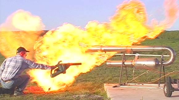

- Gippeto
- First Sergeant 3
- Posts: 2504
- Has thanked: 2 times
- Been thanked: 17 times
Something like this?
- Pulse Jet light up.jpg (26.14 KiB) Viewed 4637 times
