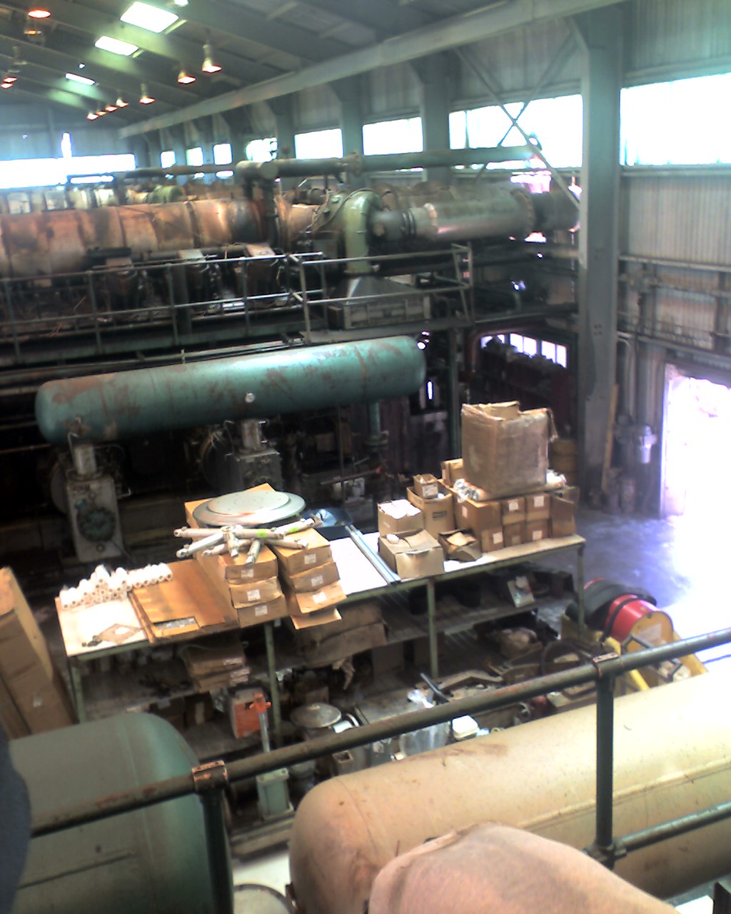

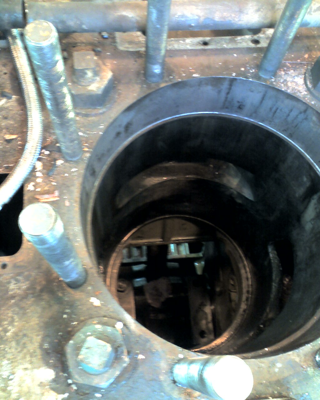

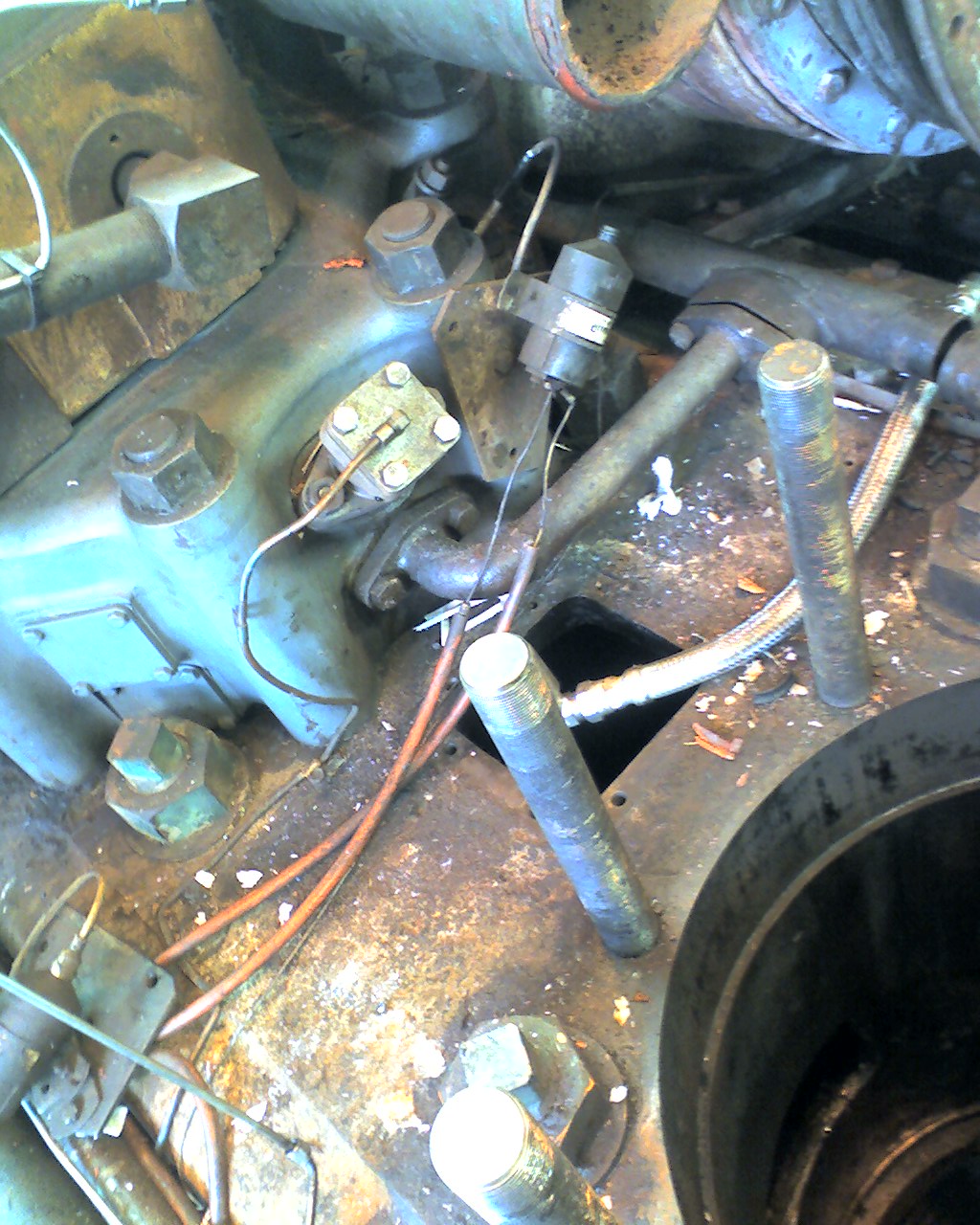

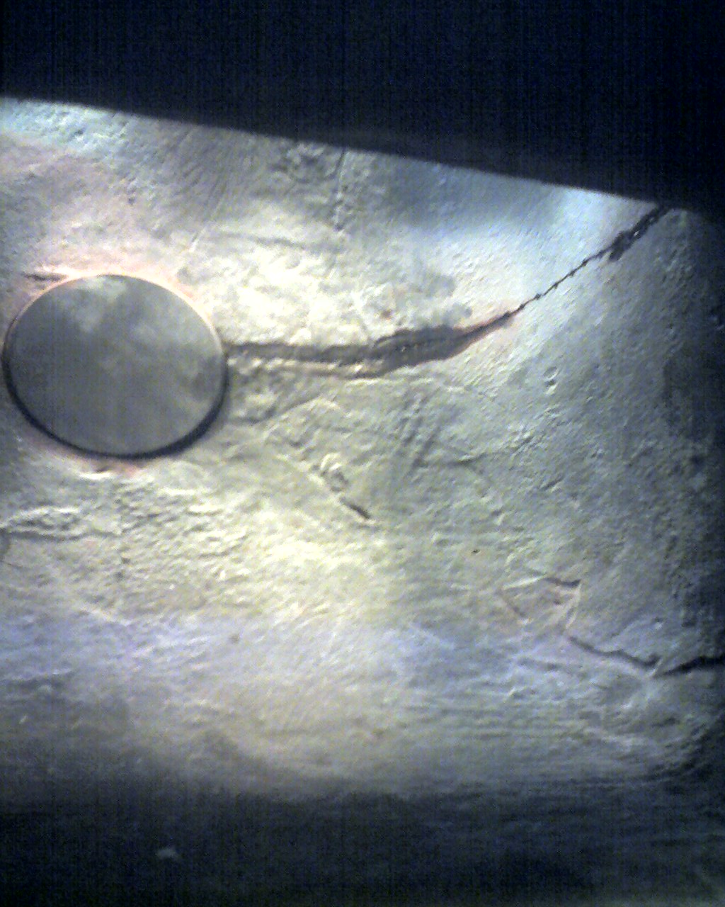

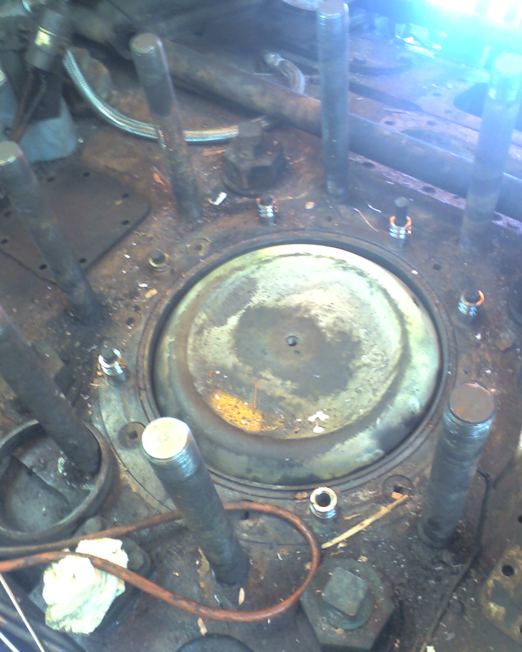

Anyhow, I got back on shore sunday night from a crack repair job for EPL East Bay on a platform ear the mouth of the Mississippi. The crack was in the exhaust port of a V 250 gas engine. I've never brought a camera on a job, but I got some pictures with my phone. I figure the yall may like to see how massive these engines are.
Questios are welcome.

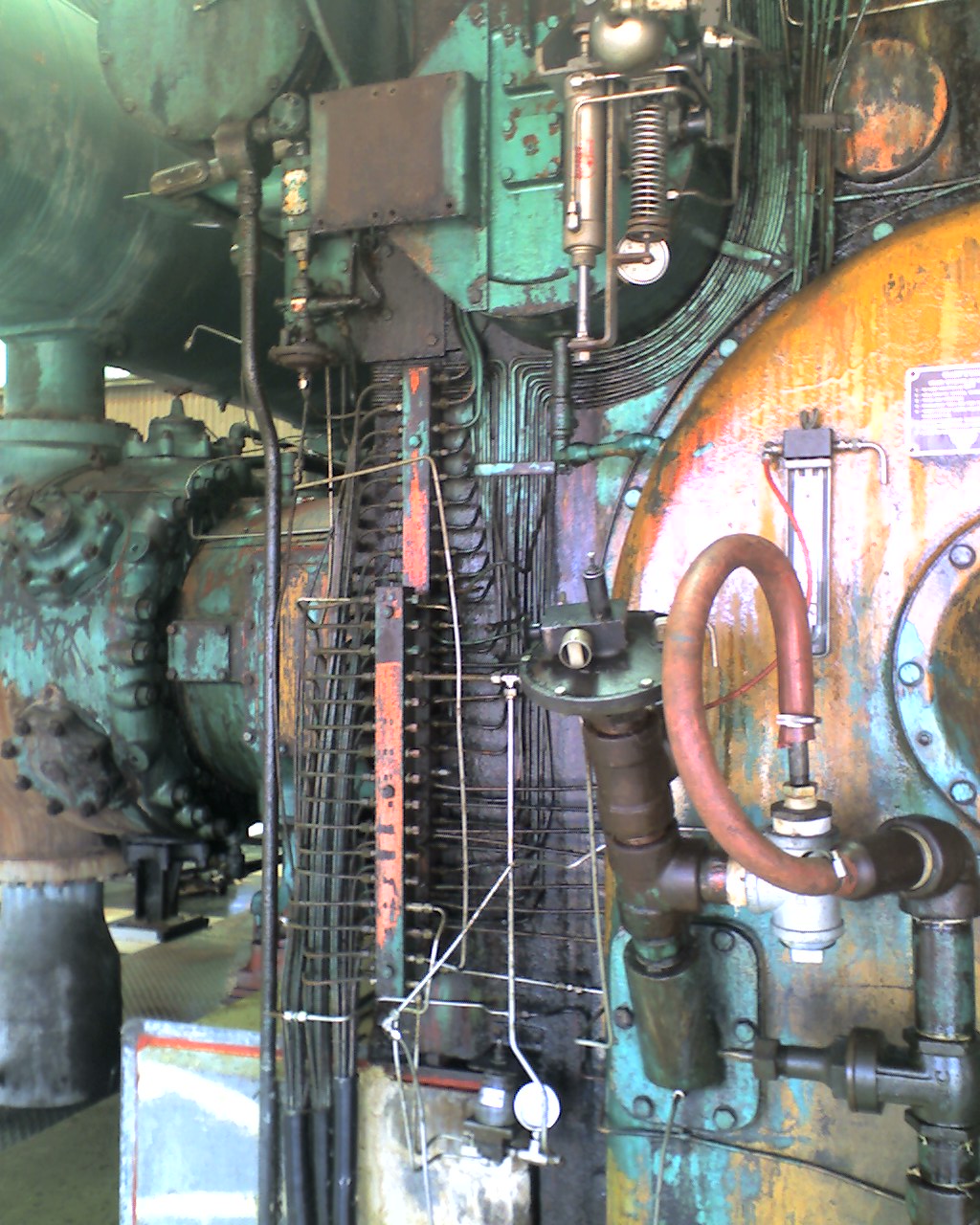

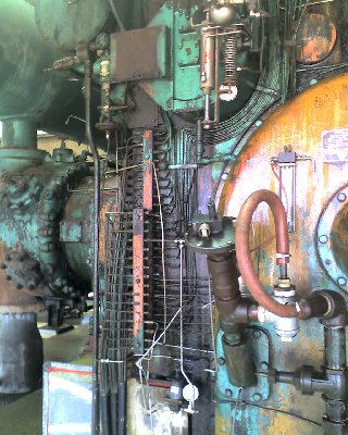

part of the power head, the air box opening and part of the cylinder

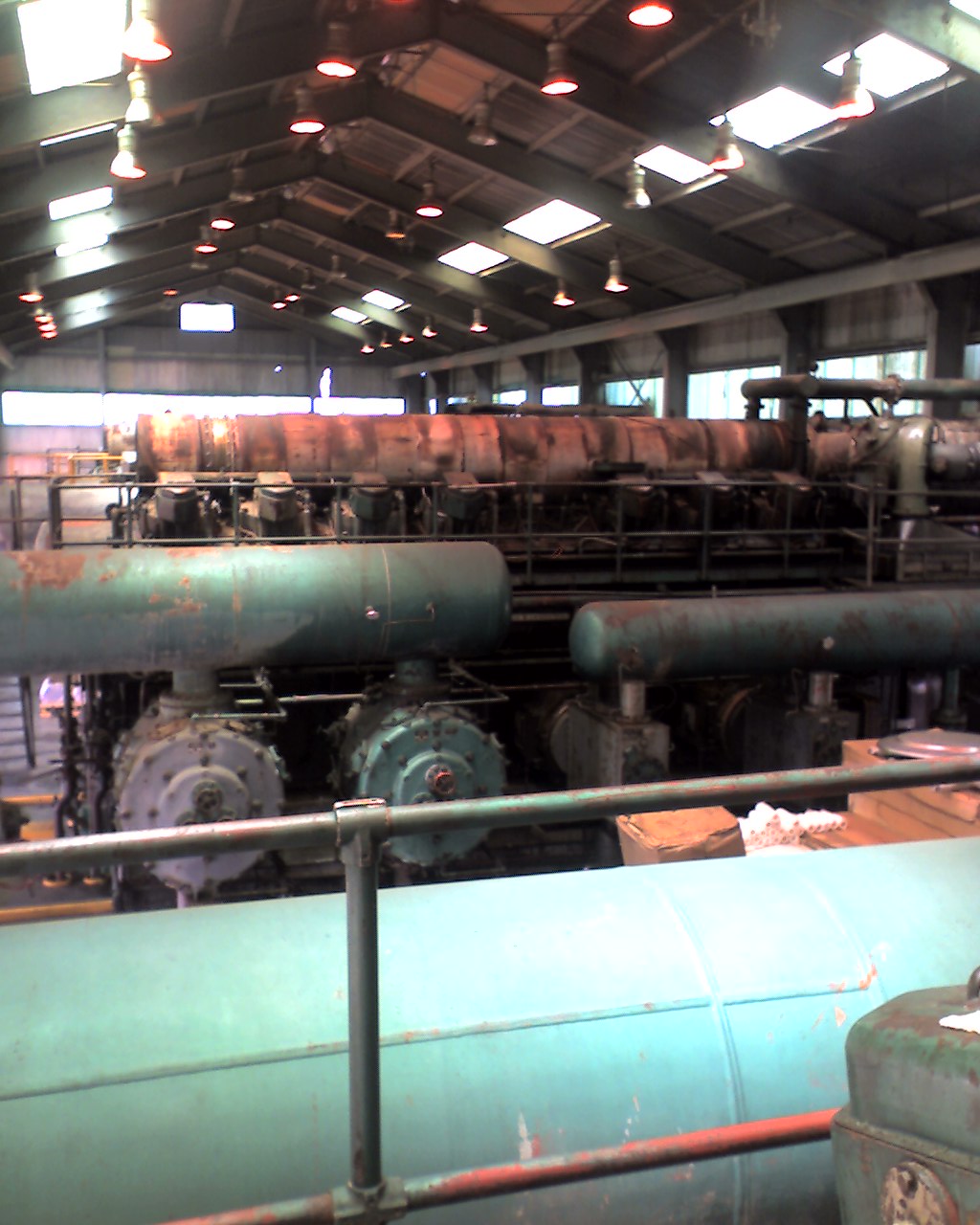

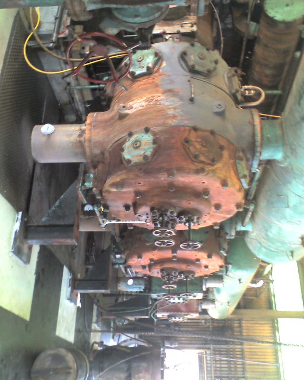

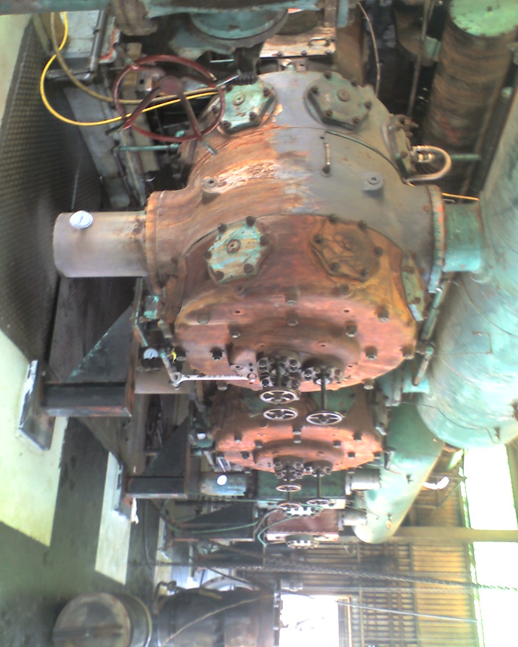

you can see 4 of the compressors
the piston on the opposing side of the block
a look at the engine building from the control room
4 pumps on one side (picture is sideways) theres 4 on the other side too

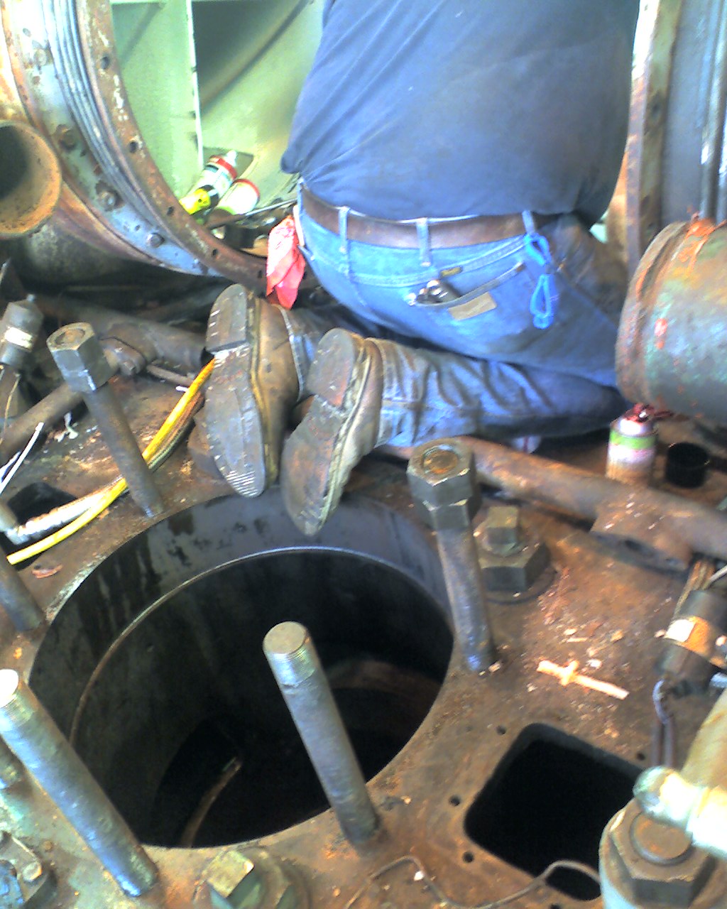

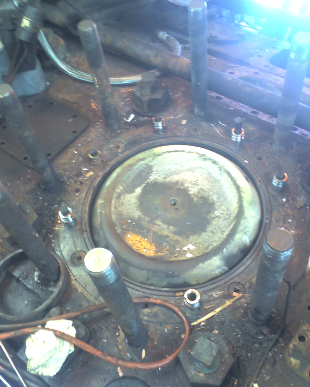

looking at the cylinder with the liner and piston removed.  and theres big john.  ever heard the song?

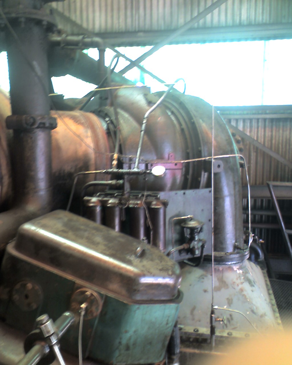

one of the 2 turbos on the engine.  about 4' in diameter

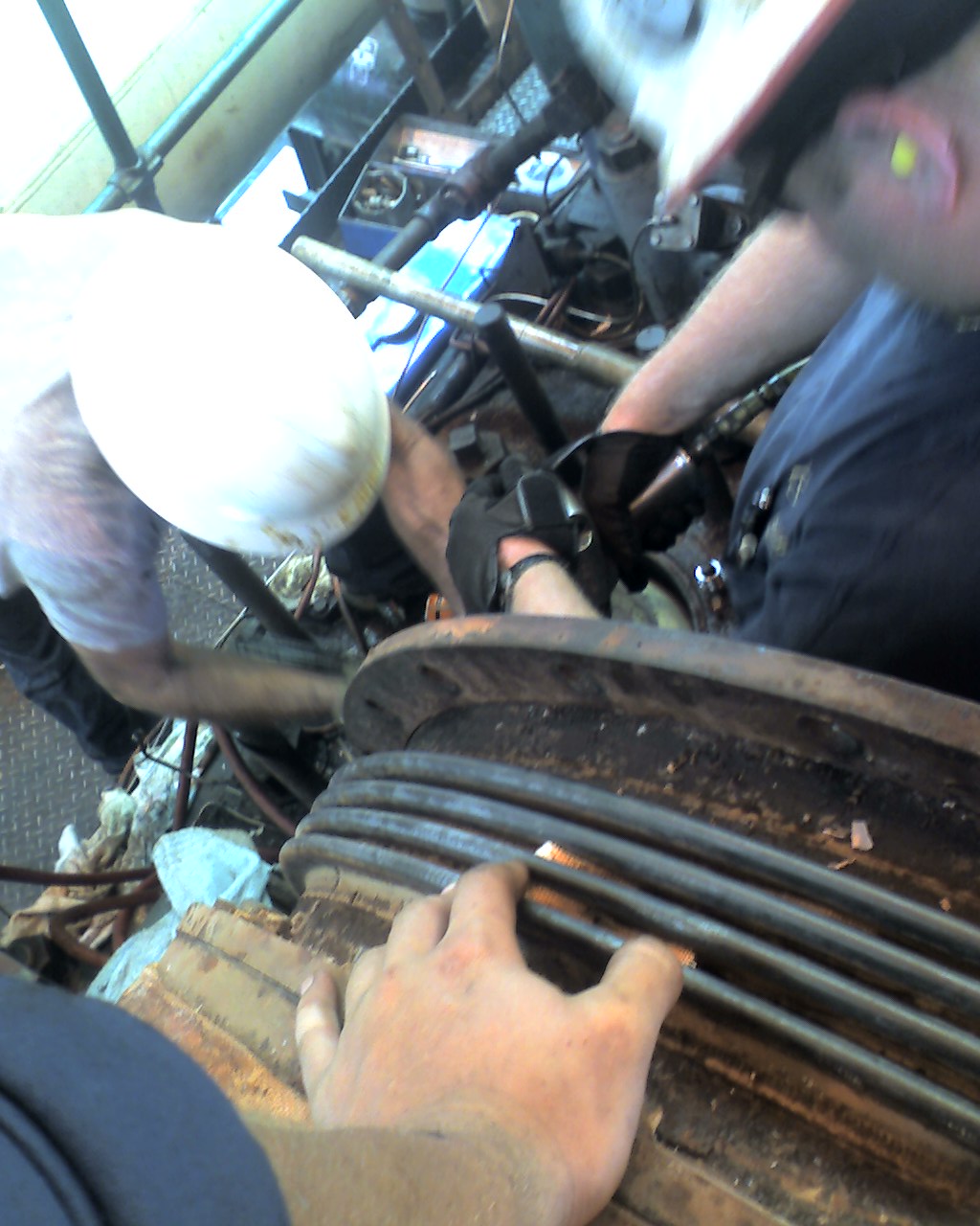

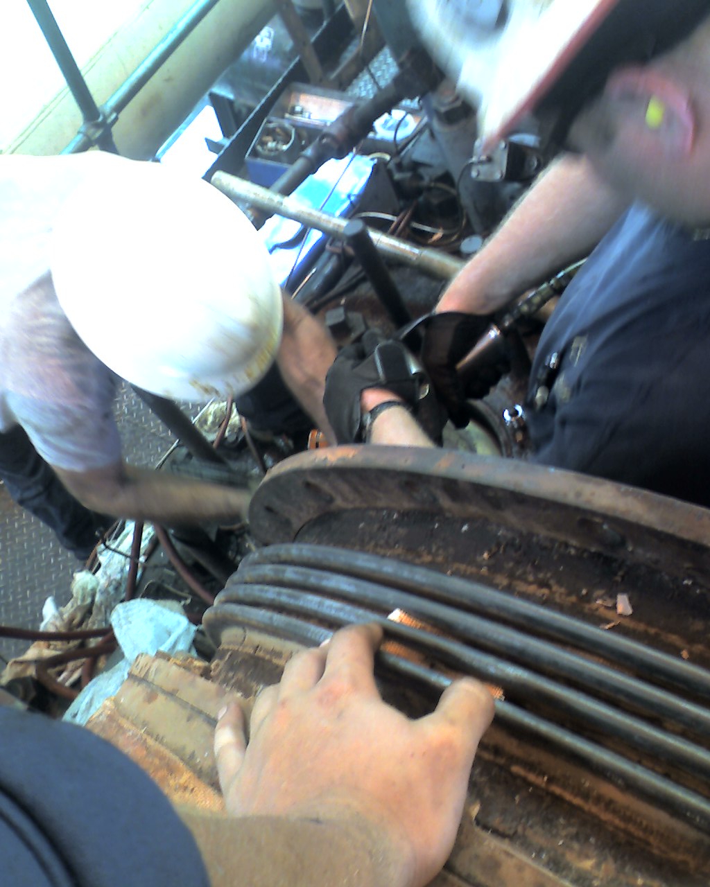

Part of the crack.  went through the water jacket.  Water came in the cylinder=bad things

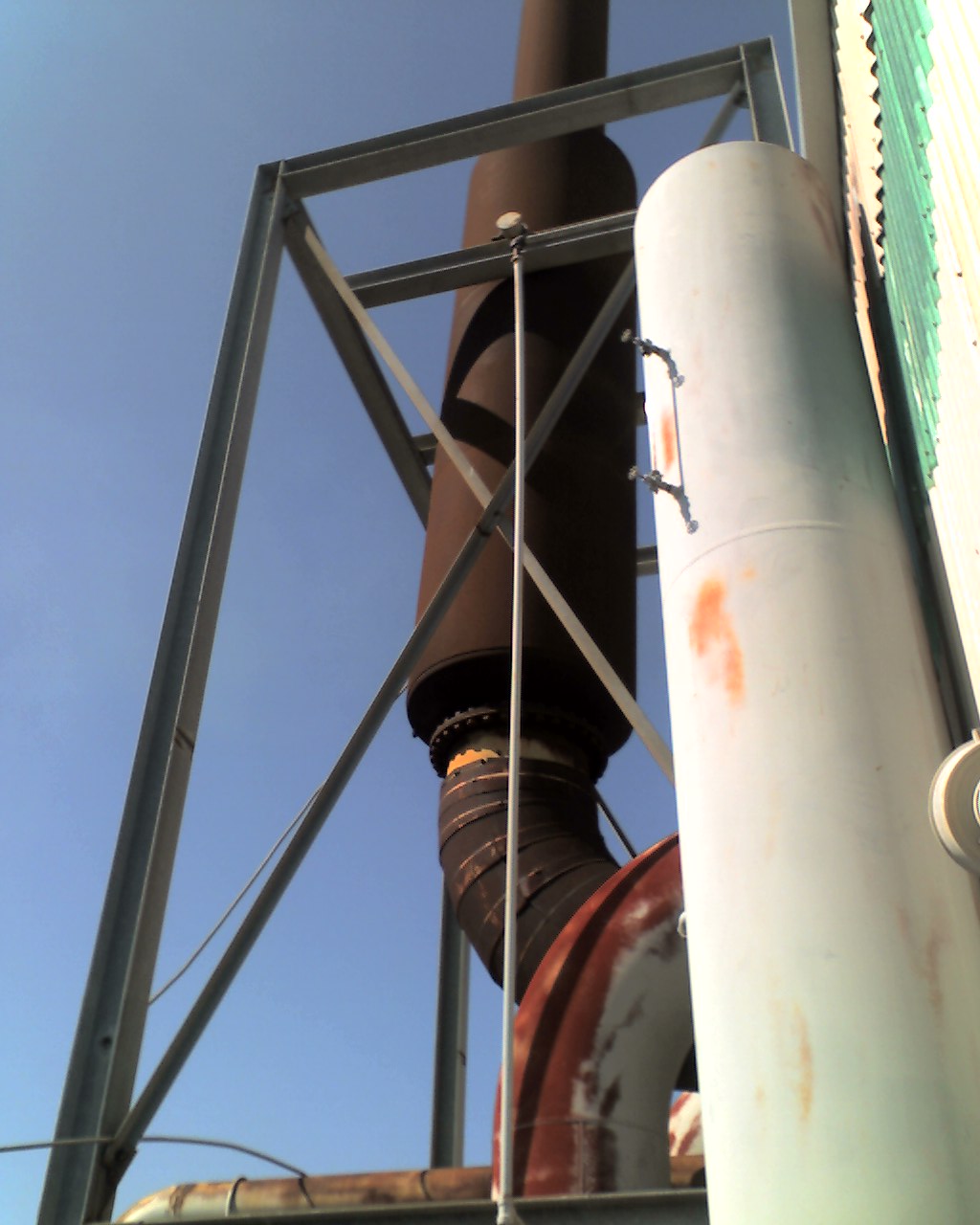

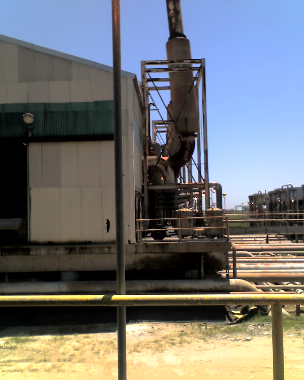

One of the four mufflers

Pretty much. I work for a company called Partco, and we do service pumps, egines, compressors. Whether its crack repair, alignment, bore checking, and we are a full service machine shop. Although I go out in the field, its as an assistant. This was a metal locking and cold weldig job. I went with a older guy ad I've been learning the process over the past year. I don't work there full time though. I'm at LSU for Mechanical Engineering. I work there summers, after school, and every holiday I can manage. It doesn't pay as well as the plants, but after a 4 or 5 16's, its a decent paycheck.

Thats one hell of a big piston in there :D

jrrdw wrote:What kinda platform are you out on near the mouth of the Mississippi? What are these engines powering? What make are they? What kinda puller pulls the cylinder liner out? (probly hydrolic) What kinda press presses the liner back in? Are we there yet?
It was more of an island than a platform. It was basically all the levels of a large platform broken down into several stations, some land based, some out in the water. I believe this station's main function was to bring oil and natural gas in from the gulf platforms (keeping pressure in the pipelines). It was the biggest station I've been on so far, and the operators were arguing whether they should be selling 4 or 5 million gallons (whether that is a week, month, I'm not sure) The engine is a Cooper Bessemer V 250. I wouldnt be suprised if it was made in the early 60's. The liner isn't quit a snug of a fit as you're probably thinking. Now, it ain't exactly rattling around in there, but it just drops in and is held in by the head studs.
As far as horsepower, I honestly don't know. I do know its in the thousands though. Also, the engine "redlines" at 720 rpm.
These engines drive compressors and pumps. You can see them in some of the pictures. They mount to the side of the block and are driven straight from the crankshaft

hmm.... i wonder if i could hook myself up with a turbocharger that big....... would make an AMAZING turbojet.......
biggsauce
Posts: 338
Thu Jun 12, 2008 9:19 pm
VH_man wrote:hmm.... i wonder if i could hook myself up with a turbocharger that big....... would make an AMAZING turbojet.......
you would need a mighty big leaf blower to spool it up... :wink:
