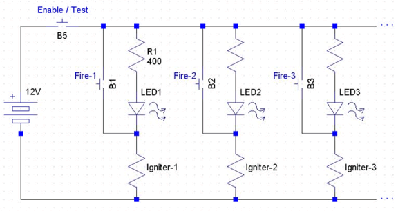

Ok, so I want to launch multiple model rockets individually from the same board. I have devised a scheme that would work using CAT6 wire, so I should be able to connect 5 ignitors to a common ground (the 6th wire). Each of the 5 firing circuits has its button or momentary switch. Each has a continuity light to let me know when the circuit is firing. However, I don't know how to make the ENTIRE setup have a continuity light. Using my current diagram, there is a master switch that gives power to all the circuits. I want a light to illuminate when I turn this switch on. How do I do that without stealing the power from the sub-circuits? BTW, I will only be firing one circuit at a time.

I would recommend using an LED with a series resistor wired across the fire buttons for each rocket. The current limit resistor would be high enough resistance to limit the current through the ignitor to a low enough value so it can't ignite. Depending on your ignition voltage, the resistor value needs to be calculated to limit the LED current to a value so it will light, but not run in overcurrent. For 5 volt systems, 470 ohm is common for indicator lights (red LED's) and 1K to 1200 ohms is common for 12 volt systems.

Filling out Tech's suggestion (I think), attached is a sample circuit using LEDs. It assumes that the resistance of the igniter is much less than the resistor for the LED. If the igniter resistance is less than about 50 ohms you should be good. The actually value of the limiting resistors should be fiddled with a bit to get the LEDs as bright as possible without cooking them instantly. RadioShack should have all the needed parts. The LED, resistor and push button for each channel will probably run about $1.50 total.
The design uses all push button switches for safety reasons. The main "Enable / Test" button should be well separated from the others and a protective cover would be a good idea.
Pushing the "Enable / Test" button will light up all the LEDs for launch channels that have continuity. If there is a wiring problem for a particular channel, it's LED won't light up. If the channel has already been fired it's LED also will not light up.
To launch you push the "Enable / Test" button and the button for the particular channel you want to fire. Requiring two button to be pushed at the same time is a good safety setup.

- launch_circ.gif (39.81 KiB) Viewed 7096 times

A key switch is recommended to prevent onlookers from launching anything during your setup. Keep the key in your pocket while setting up igniters.

A key switch is a cool idea (and a safety factor so it's a double bonus). I would still go with a pair of pushbuttons in addition to the key switch.
