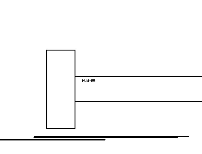

The problem is that for this gun I will use more then 500v>there will be too much loses in the swich.May be if I sqash the two contact plates with a hummer :lol:

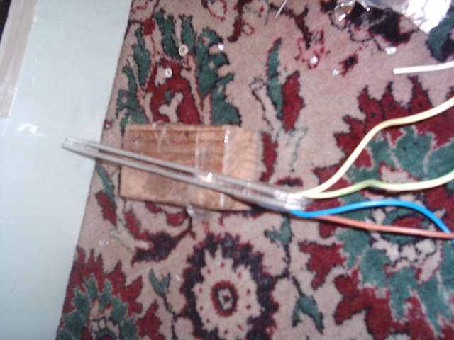

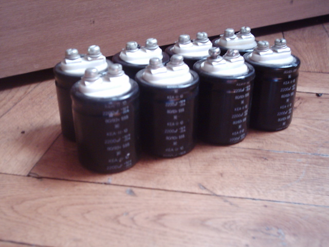

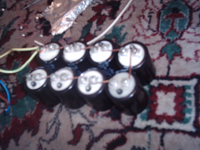

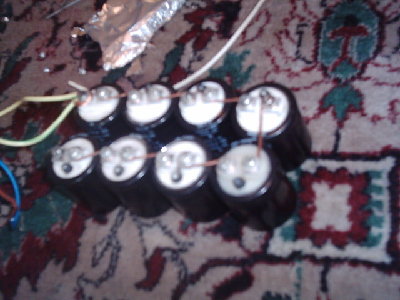

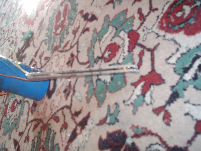

I just made my naw rail gun.It uses 8 110V 2200mf capacitors.It fires small balls from aluninium foil.But it can't do any damage :cry: Because I have no botton I tuch the wire from the gun to the capacitor.The spark is so huge that I cant remember the spark in the gun.

FiveseveN
Posts: 337
Joined: Fri Oct 14, 2005 5:48 am
Location: Nowhere
Wed May 17, 2006 12:39 pm
Man, if I had as many toys as you do when I was your age :lol:
I said I'll draw a triggered spark gap, I'll do it tonight. It should solve your trigger problem.
But why have you wired your caps in series? Do you use a high voltage source to charge them?
8 X 2200mf @ 110V in series = 2200mf @ 8800V
8 X 2200mf @ 110V in parallel = 17600mf @ 110V
And I don't see a charging resistor. Careful there :)
Rambo
Posts: 509
Wed May 17, 2006 12:58 pm
I don't think it's going to work with less then 300v.I charge the capacitors two by two with 220v.
