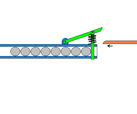

On centrifuge guns:
A shield is a design flaw in itself. Something better would be to have a steel pin or gate holding the rounds back until the trigger is pulled. This is a crude diagram but I think it gets the point across. The orange rod is moved into the path of the rotating barrel and hits the pin release once every revolution. There are more elegant solutions than this, however; it's just an example.
Not necessarily.They require very close-fitting and well-lubricated parts to prevent them from jamming or crushing the ammunition between the shield and the barrel.
- centtrigger.GIF (3.37 KiB) Viewed 4890 times
