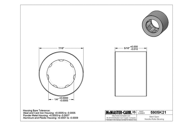

EDIT: for those of you interested, here's a detail of the bearing I'm thinking of getting for this project.

Due to the large rollers and resulting surface area, that bearing is designed to handle high loads. With the carrier shown and the viscosity of the lubricant, the bearing has a fair amount of friction, so it won't free spin nearly as well as dry skate wheels.
A small contact area bearing (Ball Bearings) will have much lower friction under light loads. Under heavy loads the roller bearings will have a much larger contact area to support the load with lower piint contact area distortion and losses. With a high load, the roller bearings will have less loss.
Sleeve bearings are generally used in low loading applications such as fans as the friction and wear goes up with loading.
I guess at this point is what size load are you needing to support? Will contamination be an issue? Open ball bearings in skate wheels shed dirt as the bearing race can eject dirt. Roller bearings due to the shape are much poorer at pushing dirt aside and work best when sealed away from dirt.
