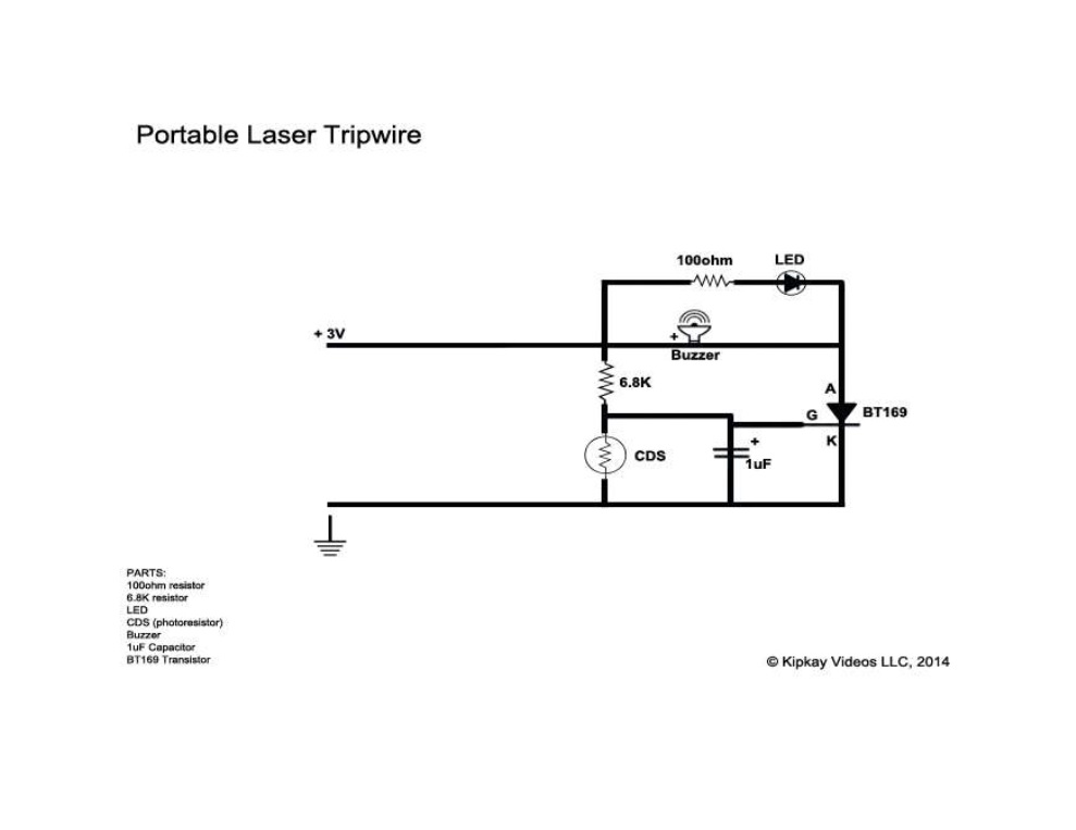

Right now I'm in the process of building a laser tripwire. I'm using KipKay's portable laser tripwire design (circuit diagram attached) with a few modifications. I replaced the buzzer with a positive and negative lead. I'm also using a 2N3904 transistor instead of a BT169 thyristor, so the circuit is tripped only while the beam is broken.
I want to use the tripwire to trigger an airsoft claymore or something like that by way of a 24v sprinkler solenoid. The problem I'm having is that I can get about 1.8v from the leads, but no useful current. I don't know much about electrical engineering, so I'm not sure how I can use this voltage to trigger a completely separate circuit for the solenoid. At first I thought I could use a relay, but that would require current. I also thought I could use some sort of op-amp circuit, but I'm not sure how I could keep the two "grounds" separate. Any help would be greatly appreciated. I already fried a transistor and an LED.
Laser tripwire circuit

Simplest solution imo would be to replace that logic level thyristor ("transistor" in the diagram) with a sturdier SCR. Then you could simply increase the supply voltage to 24 VDC and modify the two resistor values (the LED isn't necessary and that entire branch can be removed if all you want it to trigger a solenoid valve).
Your phototransistor's nominal resistance ranges will determine what resistor and its power rating to use in lieu of the 6.8k one.

The circuit as posted should have plenty of oomph to run a small relay, especially if you boost the voltage to 6V or so. If space is limited use a 9V battery.
You won't be able to use the LED to align the device since the circuit is a latch, once the thyristor goes into conduction it will stay in conduction until power is removed from the circuit. If you replace the thyristor with a transistor then you can use the circuit for aligning. Replace the 6.8K resistor with a 50K or 100K potentiometer.

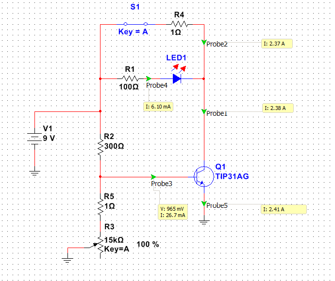

Update: I'm back at school now so it looks like I'll have to put the project on hold. However now I have access to Multisim and I tweaked the design a bit. It looks like I'll be able to get a reasonable amount of power from this new setup.
Note the potentiometer is a stand-in for the photoresistor and the 1 Ohm resistors are just to simulate the resistances of a relay and a well-lit photoresistor.

I think you'll want R2 to be bigger so it isn't wasting so much current doing nothing.
R1 also seems low. For a generic LED it is way too low but perhaps you are using a high intensity white LED? As drawn, when the LED is on it will be carrying 73mA (assuming a 1.7V red LED), and not the 6.1 mA shown on the schematic. A generic red LED will be fried by that much current.
