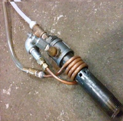

Just finished my waste (motor) oil burner
It's basically just a nozzle with an oil line and an air line attached, the oil tank is pressurized to force the oil to the nozzle.
It seems to runs best when the tank pressure is set to 20 psi (regardless of how open the air line is). The pictures below show it running on something like 20 weight but I've got a lot of 50w oil with some sort of additive that makes it even thicker (I got the oil from some amateur racers). The 50w seems to be too thick so I mix it half and half with the 20 (I'm not really sure that the oil is actually mixing or if it separates once it sits for long enough), on top of that I have to run my air line at full bore. With all of the extra oxygen, the sludgy mixture seems to burn without any smoke and the flame actually has some purple flares at the base.
The polyethylene tubing is the air line, the vinyl is for the oil input, and the male quick connect was supposed to be for a propane inlet to warm up/start the burner on but I've kind of ditched it, now I just start a small wood fire under the burner to get it going. The copper winding around the base are for preheating the oil (not sure how well it actually works though). The holes were meant to provide more oxygen to the propane nozzle through a slight abusing of the venturi effect but they work pretty well at supplying extra air to the oil stream too.
The picture's old but there's the air tank (red) and oil reservoir (PVC).
And, of course, testing the burner
Some pictures of my super makeshift foundry and the burner in action (with heavier oils) to come :D

by jackssmirkingrevenge
That is pretty fucking awesome.

You've got that working pretty darn good IMO..kudos. :)
Played with siphon burners (shop made and Delavan nozzles), modified babbington, turk and ozzirt burners for a while some years ago...are you filtering your used oil at all? Any trouble with the nozzle plugging up?

Thanks!
I'm pretty fond of siphon nozzles but I couldn't afford one, hence my rudimentary system :) . I haven't been filtering any of the oil, although this last burn I guess there was a clog in the nozzle that blew the flame out near the end of the melt, but it re-lit itself after a few minutes. I figure one clog out of 4-6 hours of total run time isn't bad.

Will check my parts box...might have something for you. Will shoot you a pm if I find something worthwhile. Price will be pics of a successful burn/melt. :wink:
What kind of fuel burn rates are you getting?
Pic above was 2 liters every 15min on 50/50 diesel/used engine oil...friggin LOUD, but a lot smoother running with the flare at the inlet end.

I'm amazed and grateful for the offer, thanks!
As far as burn rates go it usually depends on the pressure that I set the tank to, the last time I melted I had it set to 10 PSI and the gallon of oil lasted over an hour (although I didn't actually think to time it, that and I don't have a hole cut in the top gasket of the tank yet, so I'm not sure how much is left). When I run at 20 PSI it usually burns through 4-5 quarts in just under an hour.
