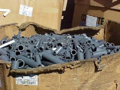

(1) PVC cutoffs ready to be turned into shavings.

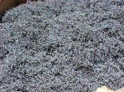

(2) PVC shaving that will be dumped into the top of Injector.

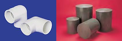

(7) Final Product that is ready to be machined.
