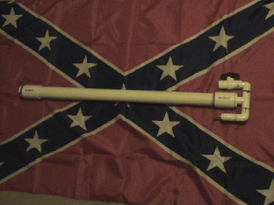

STORY TOME!! This cannon is my 6th. I named it the PVC_01, which stands for Piston Valved Co-axail and the 01 cause its my first co-axail.
Specs:
Chamber- 1.5"x3'
Barrel- .75"x2.75'
Piston- 1.5" solid type II pvc rod bored out in the back for lowering weight
Seal- Shower/bath liner($5 for 5'x1')
Pilot valve- 1/2" ball valve
Fill valve- Schrader valve
BTW i just finished gluing this cannon about 10 min ago, and was feeling impatient(sp?) so i posted it, as a result, no damage pics yet.
That about sums it up. What do you guys like/dislike?
Specs:
Chamber- 1.5"x3'
Barrel- .75"x2.75'

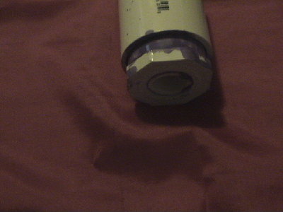

major mistake! you cemented the piston inside. and this means that when something goes wrong (which its bound to do) you cant fix it without cutting off the bushing. i would suggest change to a threaded adaper before anything realy bad happens. trust me itll be worth it in the long run
- origin unknown
- Corporal
- Posts: 533
Nice coaxial. If your launcher ever craps out on you, you can just cut the gun open and take the piston out and build a new gun with a threaded female adaptor, and a threaded male plug.

@Big-mac: yes i am taking this to the Texas meet. We will be sure to take lots of pics, and possibly some vids for all too see. Dont worry, we'll launch one for you!
Yeah, if anything goes wrong im gonna cun the end section off of the chamber and just glue a threaded adapter onto that, but like i said this was just a spare parts cannon, save for the ball valve. and I didnt think about piston service while throwing it together.

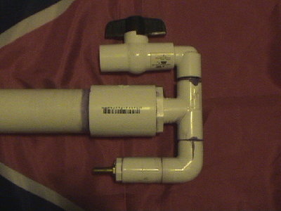

This quote from a while back suits that gun just fine, since I couldn't find the one I was looking for.
Cut down on that pilot volume for Pete's sake.
jackssmirkingrevenge wrote:excuse the delay, I was still in shock from the enormous amount of wasted air, the pictures burnt my eyesModderxtrordanare wrote:Dammit, you edited in some of your efficiency nazi'ism.![]()
-Wiki

LAWL!! yeah i coulda been better about that, well lets compare to your co-axial... OH wait...

Same thing as an over under piston, and my over-under piston gun has less pilot volume than that thing. (When it's in proper working condition)
I originally thought you used PVC_01 because of this. 8)

Yeah im not gonna lie thats my paint scheme for this gun. then will come a renaming cerimony!
Your piston gun is waiting for me to fix it in my garage. Right now it dont have a back plug so it has the pilot volume of the atmosphere.Same thing as an over under piston, and my over-under piston gun has less pilot volume than that thing.
