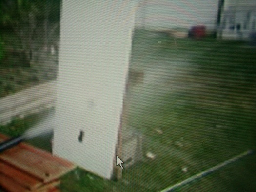

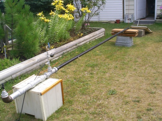

Well, this afternoon I was bored, and looking for something to do. I remembered that I still had two 1.5", 16 layer alu. foil burst disks, and decided to bring out my SCTBDC, hook on the 12' barrel, and take a shot.

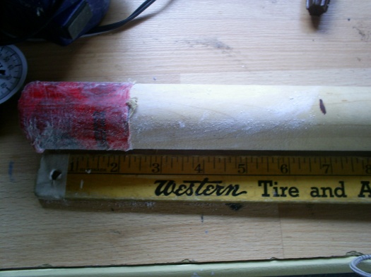

I needed something to shoot (and some ammo), and I found 2 sheets of 5/8" MDF, which I nailed together with spacers to created a 2" gap in between. For ammo, I used a 300 gram piece of wooden dowel that was 16" long, with no modification except tape to help it fit better. GGDT said that this should achieve about 330fps and 1130 ft/lbs of muzzle energy. For wadding I used a ball abou 1 3/4" in diameter made of a foam like material which sealed the barrel very well.
I loaded the gun, set up the target 5' from the muzzle, charged it to 160psi, and vented the secondary chamber... Nothing happened. I waited for a while and, as I was about to go refill the secondary chamber and try again, the gun fired. The recoil was massive enough to throw the whole 25+ pound weight of the gun and barrel 2 feet back and off the stand.
For a few seconds I was preoccupied with a 12' length of ABS pipe swinging haphazardly through the air, at some points bending almost 90 degrees. I didn't take a picture of the gun immediately after the firing because I didn't want to bend the barrel any more than necessary.
After I reassembled the firing area, I went to see what kind of damage this had done.

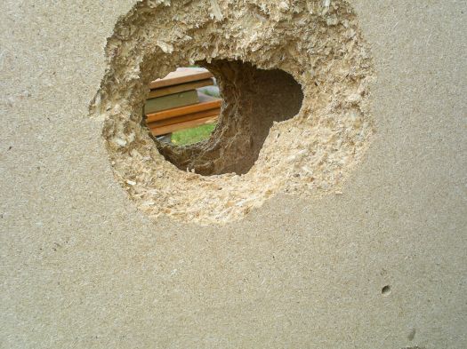

Since pictures are worth a thousand words, and this post is already long enough, I will use the pictures I took to explain what happened. I really had no idea that this projectile (1.8 square inch surface area on nose) could achieve such penetration. Please note that all of this damage was inflicted with a single shot from a blunt projectile. For some reason the pictures are showing out of order, but it shouldn't be too confusing.

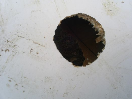

- Hole in front of target after the shot.
- chipboard1.jpg (21.66 KiB) Viewed 6607 times

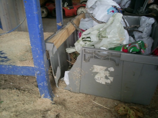

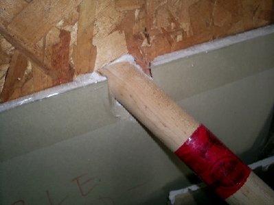

- The hole in the wall where the dowel penetrated.
- holeinthewall2.jpg (23.32 KiB) Viewed 6607 times

That's an awesome amount of power, how far is it from where you shot the gun from to the wall that the dowel got stuck in?

@potatoflinger: it is more than thirty feet from the muzzle to the wall, and it became embedded in the wall after being knocked off course from penetrating the tub
