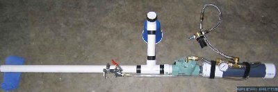

Here's a side view of the cannon. In case you're wondering, the black tape is cosmetic, hiding the blue cement I used...no, its not taped together!! ;) <br />Also, as you can see, the air system plugs into a compressor with an industrial plug. The regulator you see is a detroit pneumatics mini-reg I got for free. I love the look of those braided steel lines (also free!)

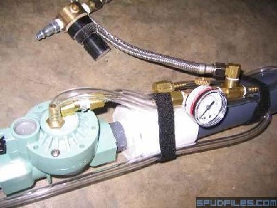

Closeup of the valve assembly. If you notice, only two screws are in the top of the valve (I forgot to replace them before taking this pic...I was previously showing off the internals of the valve to a friend)

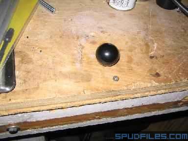

Heres an example of one of the plastic balls that I shoot.

aaah! how do you make the sprinkler valve work with the blowgun, I can under stand if it just releasis presure.
spudshot
Posts: 1036
Tue Sep 06, 2005 5:30 am
there is pressurized air on both sides of the diaphragm, using the blowgun you exhaust the air on top of the phragm, so there is no pressure above, and your chamber volume is still pushing from below, that pushes the phragm up and allows the air go to to the barrel
