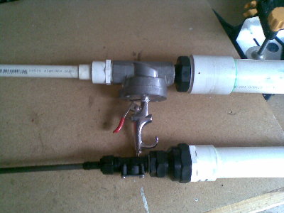

making a semi auto mechanism for 6mm - 1/4inch projectiles using Clides slider design. the barrel and mechanism will be encased in pn18 22mm - 7/8inch pvc

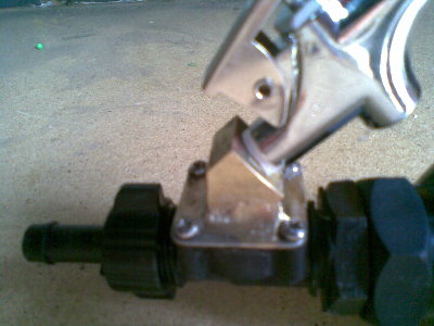

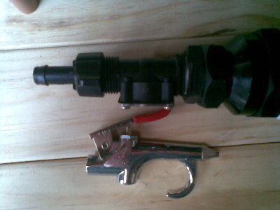

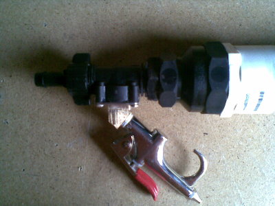

i have made the chamber and am working on the sprinkler valve
my questions and concerns are:
if i release 150psi from the valve down the barrel into the slide will it hit the projectile out of the barrel before the air forces it out a bit like the pin in a nail gun?
also how much if any performance will be lost from diverting air around/through the slide?
thanks for any answers and comments.

There's no doubt that the breech design works, right now I'm going for something similar here but hoping to use a constant flow of air for full auto fire.
I think a sprinkler valve is a bit overkill for a 6mm barrel, with this design I got very good performance using a simple blowgun - at 150 psi yours would be even better, as I'm limited to 110.
edit: Also, have you checked how long it takes the sprinkler valve to reset after firing? if it is too slow the system will be very wasteful of air.
The valve opening will be quite instantaneous so I wouldn't be too concerned, however you can add some sort of frction mechanism like an o-ring to keep the projectile in place, if anything to stop it from rolling out when the barrel points downwards.if i release 150psi from the valve down the barrel into the slide will it hit the projectile out of the barrel before the air forces it out a bit like the pin in a nail gun?
Of course you're increasing the dead space and reducing the flow, however for a decent chamber size and pressure you should still get respectable performance.also how much if any performance will be lost from diverting air around/through the slide?
i haven't finished modding the valve so im unsure at this stage.

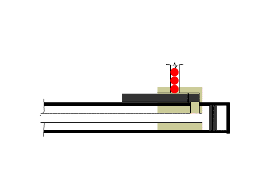

- idea for a bb pistol forgot what type of valve it is though
- pistol idea.gif (30.1 KiB) Viewed 3958 times
The above would be a manually reloaded piston valve. If you have two separate valves to both fill the chamber and pilot the valve, you could easily make it semiauto by incorporating it in your first design instead of the sprinkler. If i were you before making further progress, mod the sprinkler and see how long it takes to seal shut after firing.
i have already made a prototype of the piston valve but destroyed it because it didn't seal i have now realized i probably should have placed an o ring in the bondo/bodyfiller around the barrel for the piston to press against forming a seal.

so far now ill finish of the sprinkler make a sliding breach bolt or pump action maybe. i can always make another barrel later. and ill wait to see how ur full auto turns out then copy it

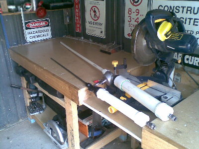

I got scared when i saw that your cannons were under a cutting saw.
Nice work and good luck with your new "Jaunt".

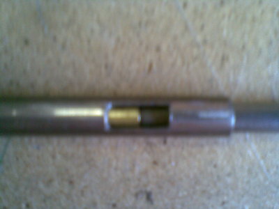

very nice fitting you made there
it should work well with a semi auto breech. As to full auto with constant flow, *stream of anglo-saxon profanities*
i wish i made that fitting. i had someone else make it for me (:
made some progress on the slide now to let the glue set. boring
