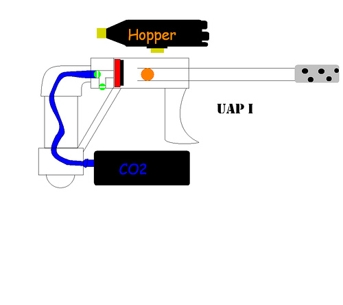

- My UAP I prototype blueprints. I'm not finished with them I need to find out where to put my custom hopper at and how to put a trigger on.
- UAP I.jpg (29.48 KiB) Viewed 4032 times

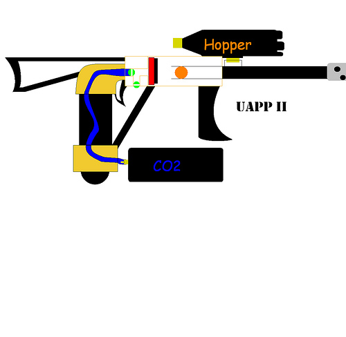

- Added color and stock, put trigger in area but still have no idea on how to hook it up. Set hopper in a good looking area.
- UAPP II.jpg (33.33 KiB) Viewed 4007 times

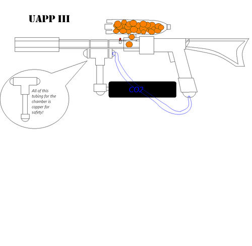

- Ok only problem is how to get stock on lol. This may be my finale design.

For any paintball gun you’re going to want either propane (green gas) or Co2.
So, for the chamber at least, you’ll want copper as it’ll take more pressure then threaded black pipe, and more cold than PVC.
For a barrel, either ¾” CPVC or SCH80, both should be easy to get and both should fit the paintball nice.
As for a valve, if your really handy you can make a hammer valve, if your not then a small piston valve should work.
You could also use a valve from a paintball gun, but that gets complicated fast trying to fit it to ones design.
Good luck to ya’!

Okay thanx for the posts... I have come up with a few blueprints, if only i had a scanner, and I made a hopper already, took about an hour but it makes me proud that it is more durable than i thought lol, and i know i want to go with CO2.
Hmm i was accually thinking a whole copper gun but that would be way to heavy i'd think so i'll go with judgement_arms idea with just copper for the chamber (i don't want to pick plastic shards out of my arms and face).
