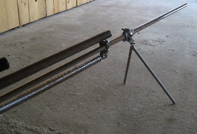

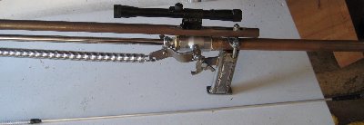

Hi all.
This is a project that i finished some time ago.
Its a springloaded ballvalve pneumatic airgun, wich fires by a push of the trigger.
I load it with about 8Bar, that equals 116PSI.
It's quit powerful, and distinct.
the pipe is shiny-chrome copper-pipe and the rest is some scrap metal i found at home.
well, hit me with your thoughts, but please spare me the "give it a paintjob" comments, I do can count that out myself.

Very nice. It would probably look even better with a stock on it.
If possible, you should take the pressure higher. Also, some damage pics would be nice.
That's one heck of a screen door spring you have there...it is a unique feature however...maybe a little out-of-place looking....maybe you could hide it inside another pipe there.
Otherwise, looks like clean and solid construction.
Amazingly nice construction!. I started work on a springoaded ball valve gun. Better stock, everything else is crudier:( I've had a lot of trouble getting the springloaded set up right.

hey that really good looking gun - it seems that it can take 300 psi easily
in case you want to improve performance consider buying a QEV valve
With that spring I bet the valve is opened to full barrel diameter in less than 10 milliseconds.

That is a very similar spring loaded setup to the one i used on a cannon I posted a while ago, it does improve the power over just a ball valve incredibly, the only difference to mine is the trigger setup and the type of spring.
pizlo wrote:With that spring I bet the valve is opened to full barrel diameter in less than 10 milliseconds.
-Yes, it´s a quick and distinct opening of the valve.
POLAND_SPUD; Yes i know. I just haven't made my self a proper shockpump yet
starman: i like the exposed spring, i mean, in this case it does a lot to the appearance in a good manner i think.
hubb017: yes, perhapse.
Nice gun, but I do agree, make a stock, and how is the accuracy.
