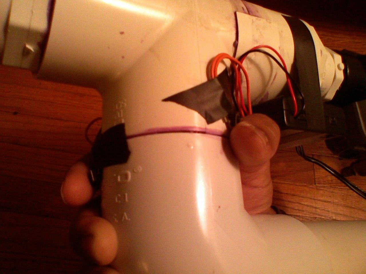

Just thought I'd keep people posted on my progress. Last time I posted, I still needed a power source and trigger mechanism. Seems like the common thing to use are 3-9v batteries and some sort of push button switch to activate the solenoid.
After working on an unrelated project, I came up with something that works pretty well. I took apart an old camera and discovered that the flash circuitry could be adapted to power my solenoid and the cool part is that it only runs off of 2 AA batteries.
Here's the concept:
Normally when you fire up a flash on a camera, a transformer charges up a Capacitor which stores necessary voltage(this one was 330V) to power the flash. Obviously, 330v is a bit much for the solenoid. So I removed the original capacitor and replaced it with a 35v one and now I have my power source. I added two micro switches to activate the power source. One is to fire up the transformer to charge the capacitor(that's the high pitch whine you hear on a camera when you push the flash button and the other is for the trigger. This sort of works as a safety because the gun won't fire unless you hit the charge button first. It only takes a few seconds for the capacitor to charge then you're ready to fire..
Another feature of this system is that the capacitor discharges in a very quick burst. What this means is that instead of keeping the solenoid open and expelling all my air, it opens and closes real quick so that I can actually get 2 shots out of my air chamber. If I fill the chamber to 80 psi, I can usually get another shot at about 50 psi before having to refill the air. Cool!!

A rough mock up of it attached to the handle
Notice the charge button is by my thumb
