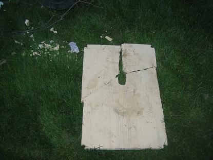

I have finally done a damage shot, after all this time of fixing the valve, although i am not completely done yet. School just gets in the way too much.
(sigh)
But here is the pic!
YAY my first time working with the uploader!!
More to come
This shot was done at under 30 psi, probably 10-20, couldnt tell with my guage.
Damage

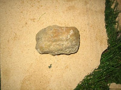

Ammo<br />Primitive, but powerful<br />So i guess rock beats wood too (corny)
Ammo

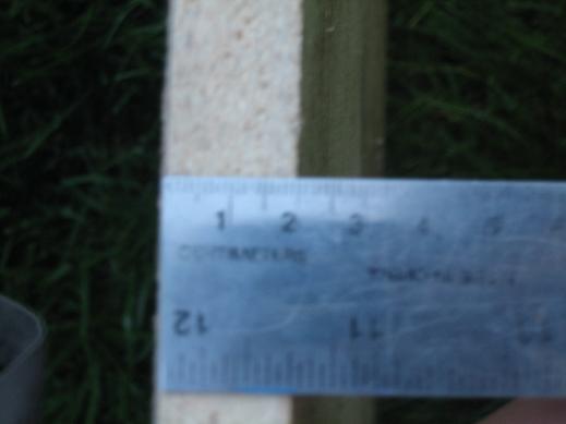

2 centimeters thick
2 centimeters thick
