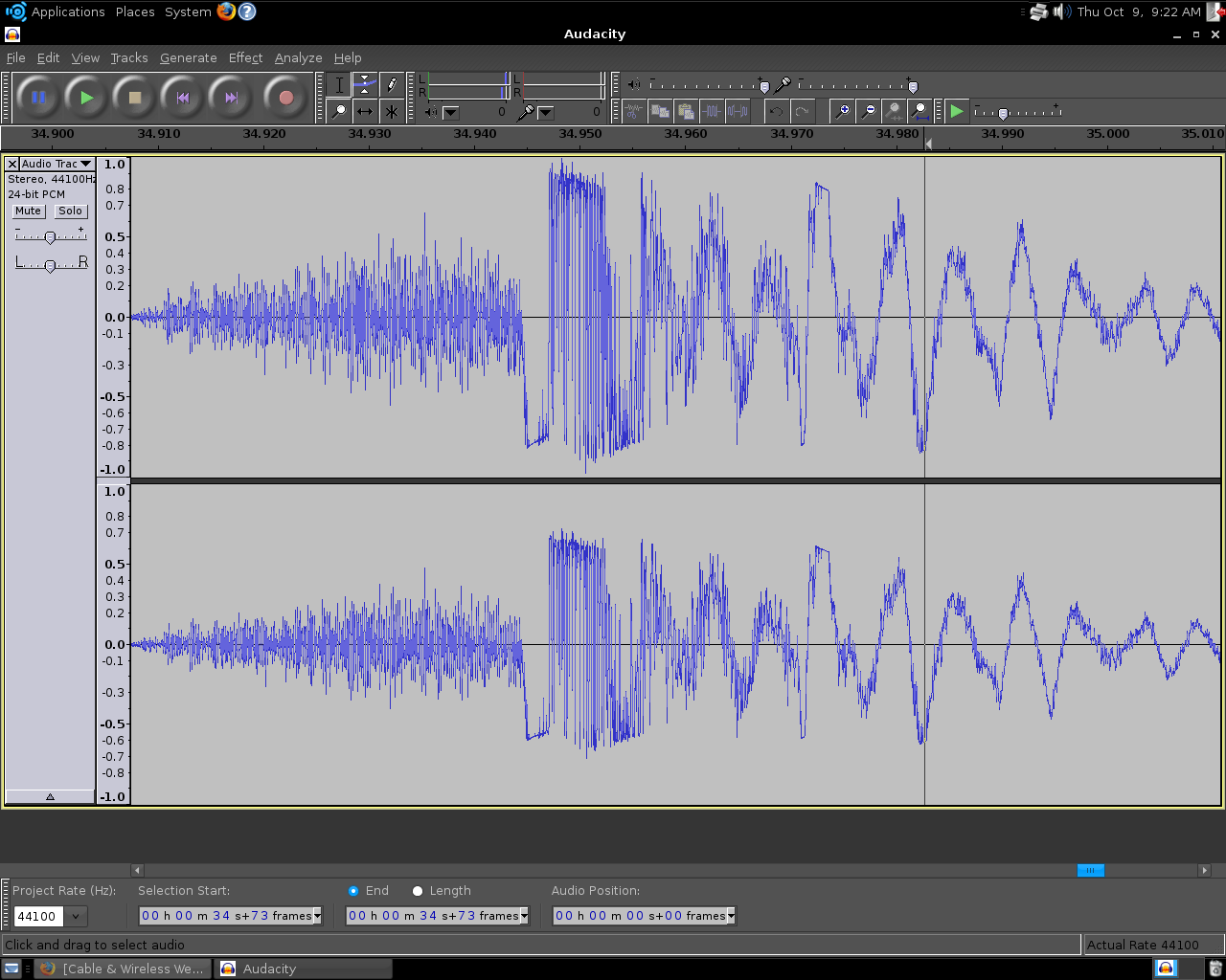

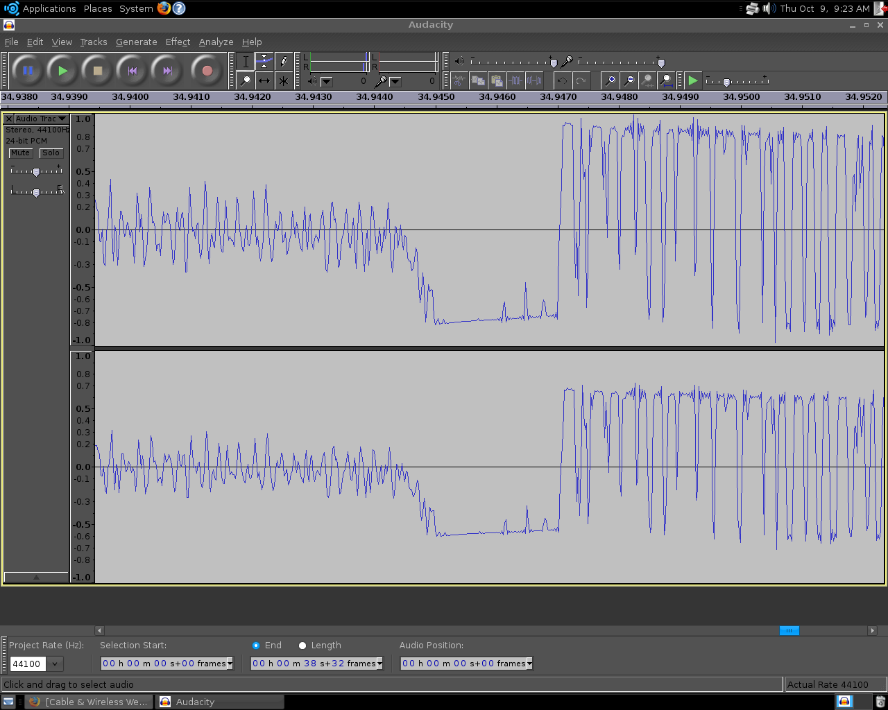

Attached again is the sound of the Mouse Musket firing. Compare it to the sound of his in the video. It has a sssssBoom. A fast pilot or very small pilot are not needed to make these work at peak performance.
My latest 3 cannons have taken this ratio to an extreme. The piston seat to diameter ratio is 1:1. To model it, there is no force on the piston when the pilot pressure is 1 atm (0 PSI) 0 bar. It requires a gentle mechanical pull to unseat it. When the valve is unseated, the piston again compresses the pilot area to about 1/2 the original volume or 2 atm or 15 PSI. This is in contrast to the 100 PSI chamber now exposed on the face. 100 PSI vs 15.. It opens all the way and remains there. As the chamber pressure drops, so does the pilot as it has a large vent. This style has the boom without the hiss.
EDIT.. Adding some info on the waveform below. The sound was recorded on the computer with Audacity. The trigger is a 1/4 inch ball valve opened slowely. this is why the hiss starts small and builds to a peak. After the peak is reached, the pilot pressure dropping caused the hiss to drop off again. This is clearly seen. When the pressure dropped off the main piston lifted and the opening is very quick and loud. The sound recording equipment clipped the signal so the boom has the flat clipped signal. Following the main discharge many room echoes and barrel resonance lingers on.
