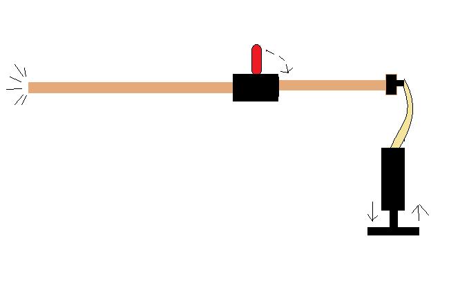

i mean a pump with a cable on it, or a bike pump.
doesnt matter, here is a good example:
(Here is quick pic i've made)
i dont know it's working but if it's working then i dont know how to build the valve on it,

do you know how to solder? if not i would recommend building it out of pvc. the most basic you can get would be a ball valve. just get like a 10 foot section of pressure rated pvc, a ball valve and cap to match, and a schrader valve and gauge if your pump doesnt have one. then cut the ten foot section in half put the ball valve in between. then thread the schrader and gauge into the end cap and glue it all together. and you will need some pvc primer and glue. thats as simple as i can think of.

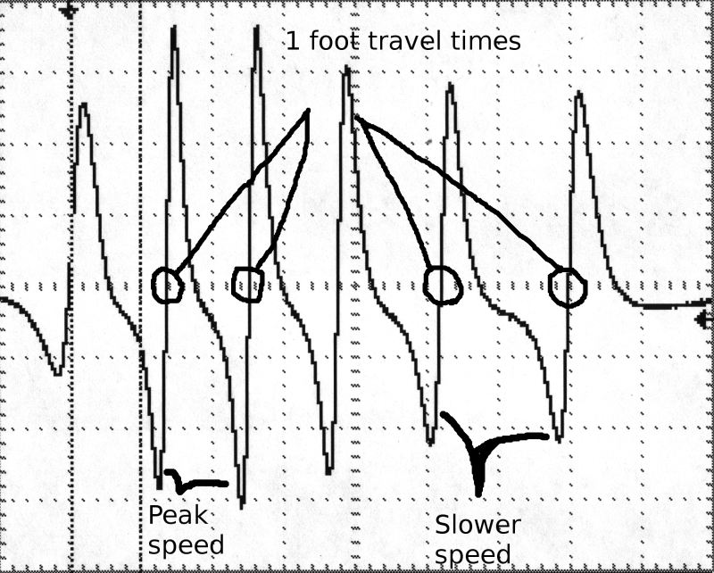

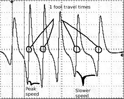

roboman wrote:It all depends on your barrel volume...if the volume of your barrel is less than that of your camber, it leads to reduced efficiency...ideally, you want about a 1:1 C:B ratio.
Just out of curiosity, why does it have to be made out of metal? PVC is much less expensive, and quite a bit easier to work with.
That statement is a generic rule. The real world will need to make changes based on operating pressure and valve efficiency. With a 1:1 ratio and slow heavy projectile, at 1 bar pressure, the projectile will leave the barrel at 0 bar pressure. With a faster lighter projectile, the valve inefficiency will require either a shorter barrel, larger chamber, or higher pressure. Pumpkin cannons operate at low pressure and benefit greatly from oversize chambers.
On the other end of the pressure range and with a fast high flow valve, great performance can be achieved with a small chamber. The small chamber high pressure guns are a prime example of this.
Here is a recent example, the Decimator.
It is in this thread.
http://www.spudfiles.com/forums/decimat ... 18647.html
Thanks Jeepkahn for the excellent example. :cheers:
I have test data on a in barrel launch where at low pressure, a 1:1 volume ratio is a poor choice because the projectile slows down prior to leaving the barrel.
Below is a chart with a low pressure launch. The blips are located for every foot of travel in the barrel. Peak velocity is achieved at about 3 feet and then drops off for the remainder of the distance in the barrel.
I like a 2:1 ratio myself, thats your chamber should have 2 X the volume as your barrel.
Funny, If I have to hand pump it, I like it the other way around. It's less work and not much drop in performance at higher pressure. :D With the small compressor I use, the large tank cannon is about 10 minutes between shots at 60 PSI. With the little cannon, it's 80 PSI shots as fast as I can reload. For raw power, it is true the large chamber does perform better.
Projectile is slowing in the barrel at low pressure.
Last edited by Technician1002 on Thu Jul 23, 2009 7:26 pm, edited 3 times in total.
