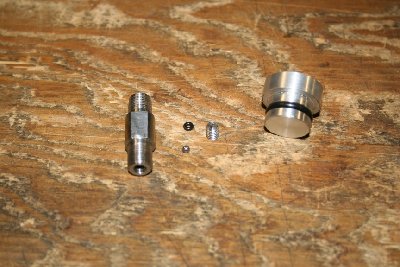

And a pic of one of the checks I built. It's good to 9000psi.
No spring in this one, it relies on orientation to initiate the seal. The small threaded piece is drilled out to provide travel for the ball, and it also holds the o-ring in place under flow conditions.

@Gippeto: my check valve setup looks exactly like the bottom right valve in the link you posted. almost exactly. and for some reason It doesn't work...

If you're using epoxy to hold the check in or together...that's likely at least part of the problem.
Compressing air creates heat, which is the death knell for any epoxy I've ever heard of.
Threaded connections, or solder (preferably a higher temp solder) are the tickets to success, safety, and longevity.

Gippetto, I looked over your tutorial once again and I think I may attempt this. It seems to be that I could easily build this into my setup without much trouble AND not worry about catastrophic failure.
