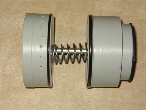

This may be a simple question for many people out there on Spudfiles and you might even think I'm dumb(I understand if you do). But I just can't figure out how the supah-valve from SGTC works? I found pics and some info on the Wiki but I still can't understand it.

I already know how a piston valve works and the different types of piston valves. I have looked at the animation many times. I have also looked already on the wiki like I said but all it has was pics and a small bit of info that didn't help me much.
The question I was asking wasn't what type of valve it was or how the type of valve works? I just wanted to know how this can work since as you can see in the pic below the piston is on a rod and it also has a spring inbetween the piston and the other thing ,I don't know what its called.

I think the spring is a built in bumper.

Can you tell me what exactly is a bumper?Gun Freak wrote:I think the spring is a built in bumper.

It is a component on a piston valve that softens the piston's landing so it doesn't break the valve. In this case, the spring absorbs some of the shock so less force goes to the back of the valve, if it even is a bumper. I'm pretty sure that's what is it though.

Ah I see. Cool well that answers my question thanks! I guess this post is closed. I don't know how to do that but oh well. Thanks again!Gun Freak wrote:It is a component on a piston valve that softens the piston's landing so it doesn't break the valve. In this case, the spring absorbs some of the shock so less force goes to the back of the valve, if it even is a bumper. I'm pretty sure that's what is it though.
This particular valve and piston function nearly identical to a chamber-sealing sprinkler valve. The rod acts as a guide for the piston and is fixed to the back cap. The piston fits around the guide rod, allowing it to pass through the piston. It also serves as an equalization hole for the chamber, that is, it allows air to pass in between the gap of the rod and the piston.
The spring, in this case, not only acts as a makeshift bumper, but also allows the piston to seat much easier.
The Sprinkler Valve (in the Hubb Library) will explain these types of valves in much more detail.

I think you'll find that a damp sock or a small kitten would count as a makeshift bumper, a coil spring on a coaxial rod is actually quite professionalHubb wrote:The spring, in this case, not only acts as a makeshift bumper, but also allows the piston to seat much easier.
