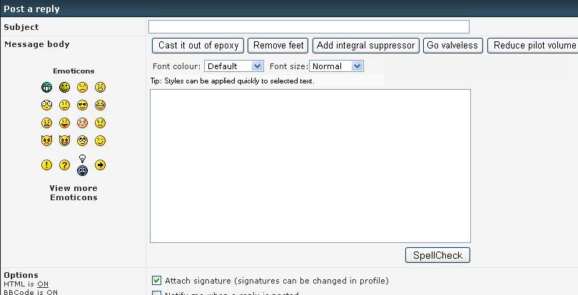

Thu Apr 21, 2011 2:39 am
@JSR Hey... its a valid button... But you seem to have forgotten to "program" a standard "epoxy advice" button...
^(O_o)> Hi there
>(O_o)># I made you this waffle!
>(O_o)># then I remembered you were a dick.
(>#<) So I ate it.

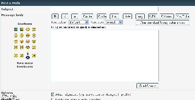

Thu Apr 21, 2011 2:51 am
ThornsofTime wrote:@JSR Hey... its a valid button... But you seem to have forgotten to "program" a standard "epoxy advice" button...
Fine, in the interest of balance:
Thu Apr 21, 2011 7:33 am
you forgot about random innuendo and APFSDS rounds are so fuc#### awesome (let me post another pic of them) buttons :wink:
anyway you're just jealous...
