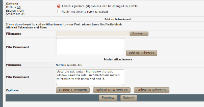

- Technician1002
- Posts: 5189
If you crop photos to a smallish size to meet the filesize limits of Spudfiles, you can edit a post and add photos by using the add file button below.
