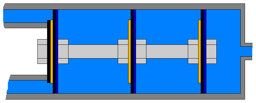

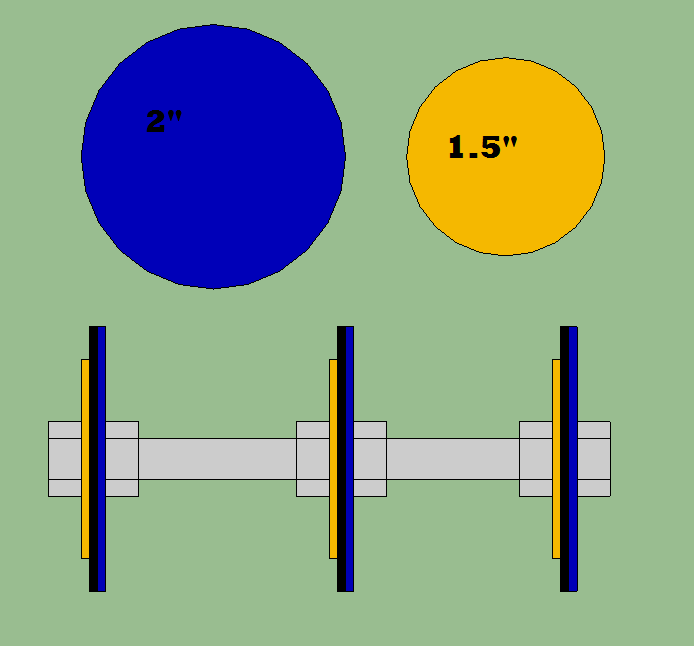

Actually, while building my last bolt washer piston, I found out that a check valve could be made with rubber washers the same size as the sealing face. I will draw it up in a second.
Alrighty here it is, if you understood my last diagram you should understand this one too. Very simple. You need three of the rubber washer setups.

why do I need three? washers on the bolt? and how do i make sure that the pisotn goes back when the vlave is piloted? doesn't the washer on the left have to be biger than that of the right, so that it will go in that direction since it would have more force?
Sat Sep 03, 2011 11:15 am
CannonCreations wrote:doesn't the washer on the left have to be biger than that of the right, so that it will go in that direction since it would have more force?
The barrel internal diameter should be smaller than the main piston diameter.

Jack, the rubber washer on the left was the sealing face. No need to add one, but it could be changed to use a barrel other than 1.5".
Sat Sep 03, 2011 11:26 am
Gun Freak wrote:Jack, the rubber washer on the left was the sealing face.
Noticed after I made the diagram when I saw dewey-1's rendering :)
