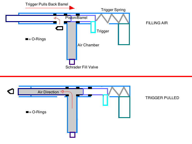

Here is another picture if things are still unclear

this method is kind of like urs gman, but its single shot...

I dont think it will work well, you will have to pull the trigger very fast to get consistent power, for semi auto check out JSRs post in the how to section, you can make a semi auto out of a qev and a slide valve very cheaply, all you got to do then is make a blow forward bolt and your set.

No it's a QDV... so the trigger only puts it in motion then the pressure opens it quickly.

It wont pull it back though, theres nothing for the air to pull, it will just leak out the barrel

Yes, that blue line in the back of the barrel is where the pressure acts on.
You got the large lines, but this is not how it really works.
Firts, the QDV used is a "differential" one.
It is put in motion by the user, then a larger seat takes all the pressure and pulls the piston really fast.
And there's a space between the chamber and the hole in the barrel, to let the "blowback" system give a big acceleration to the piston.
Also, a simple QDV does not open by itself at all.
The only reason it will open fast, is if the projectile is heavy or if there's a big reduction in front of the QDV.
With a light projectile or a blank shot, it's almost as fast as opening a 1/4valve.
- Technician1002
- Posts: 5189
Air has considerable mass. Without mass the airplanes could not fly. The mass of air in the valve is enough to pop open a QDV without a barrel attached.
There is no halfway open on my 2 inch QDV at 100 PSI. It is closed, or all the way open, even without a barrel attached. The mass of air exiting is enough to blow a impact air wrench cross the floor from 3 feet away. That is more than enough force to pop the piston open when triggered.
Without a barrel, projectile, etc, I think it is faster than a 1/4 turn valve.
Take a look for yourself.
From valve closed to full amplitude noise from the open valve is about 0.005 seconds. No projectile and no barrel.
Sound file of the 3 gallon tank with the 2 inch QDV.

My mistake, I was talking about a QDV in the size of the launcher this topic is about.
You're right, with such a big QDV the air pushes the piston, even without barrel.
Even reminds me that I made a video 1year ago with a 3/4 one which shoots pretty well without barrel:
www.youtube.com/watch?v=UWvhl6VWSTk
But I once tried a 8mm QDV, and it definitly doesn't work well without something to restrain the pressure for a while.
I was shooting at 50bars:
-with steel bb, a nice bang and great amount of power
-with plastic bb, a fairly low "puf"
-blank firing, something like "psshhht"
With low diameter QDV it's really important to figure what you're about to shoot with it, and eventually design it so the pressure can push the piston.
Differential QDV works like a charm fort this
Barrel reduction is nice too, but larger seats means much higher stress for the piston.
(in the meantime, differential QDV means strong blowback...)
