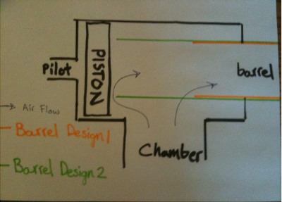

the first of which is how far the barrel should be extended into the piston housing. I drew a simple diagram that compares how two different barrels are positioned, one going farther into the housing while the other does not pass the bottom socket of the tee
based on my knowledge, it seems like design 1 (the shorter one) would get better airflow than the other design. does anyone have experience that would confirm that?
It also seems that if the first design was used, the piston would have to travel farther to open fully, which leads to my second question about piston travel distance. I've heard of the d/4 rule for coaxials and the d/2 rule for barrel sealers (which is what I have), but I'm not sure which diameter it should be based off of (the port hole or the piston face?) . I've got 2" sch 40 PVC for my barrel, which makes the diameter of the port hole just over 2" and my piston face is just under 3". Also, would the barrel's position affect how much travel distance the piston should have?
