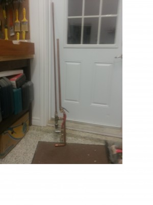

This is the 1.5" cannon. Barrel is not screwed in in the photo (1.5" sdr21 sleeved in sch80 pvc). First dry fire at only 50 psi was surprisingly loud, and it sounds really efficient. I plan on reducing the chamber size and adding barrel support.
GB cannon
GB cannon

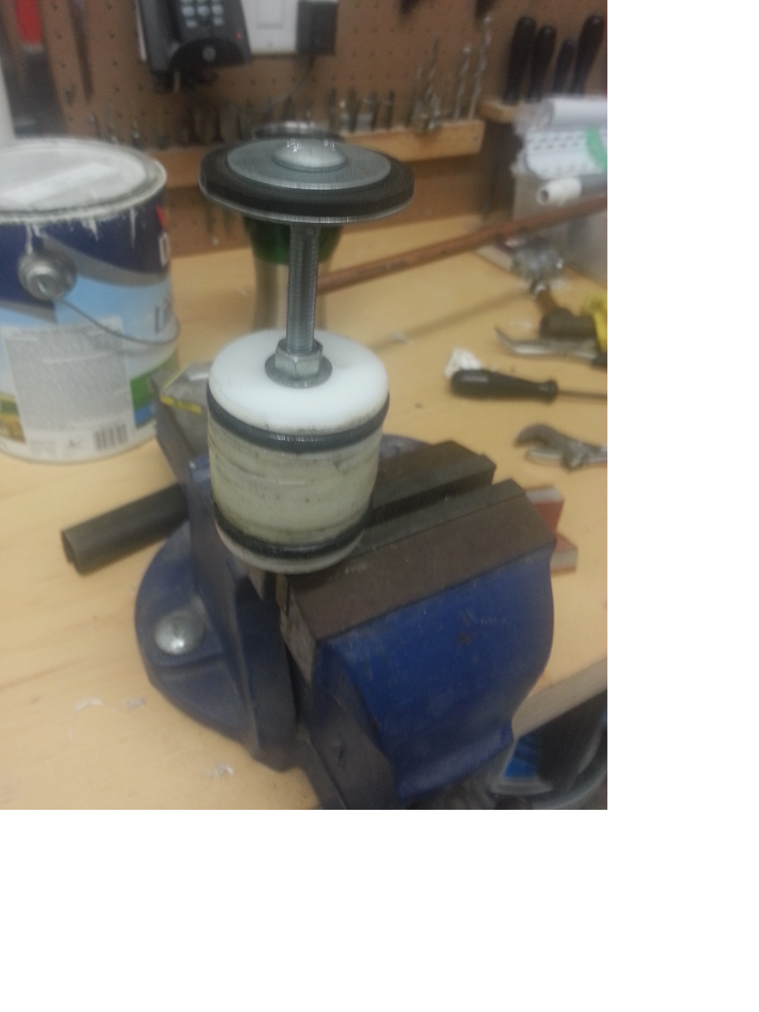

Piston needs a minor fix as it seems I've got metal on metal near the sealing face so there's a tiny leak from that.
Piston for the 1.5" cannon

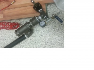

The filling and pilot station works well, although I would like to make it a bit more aesthetically pleasing. Some elbows might help for it to be more "in-line" but any recommendations would be great. Uses a standard modded sprinkler valve as a pilot.
Pilot/filling area
Pilot/filling area

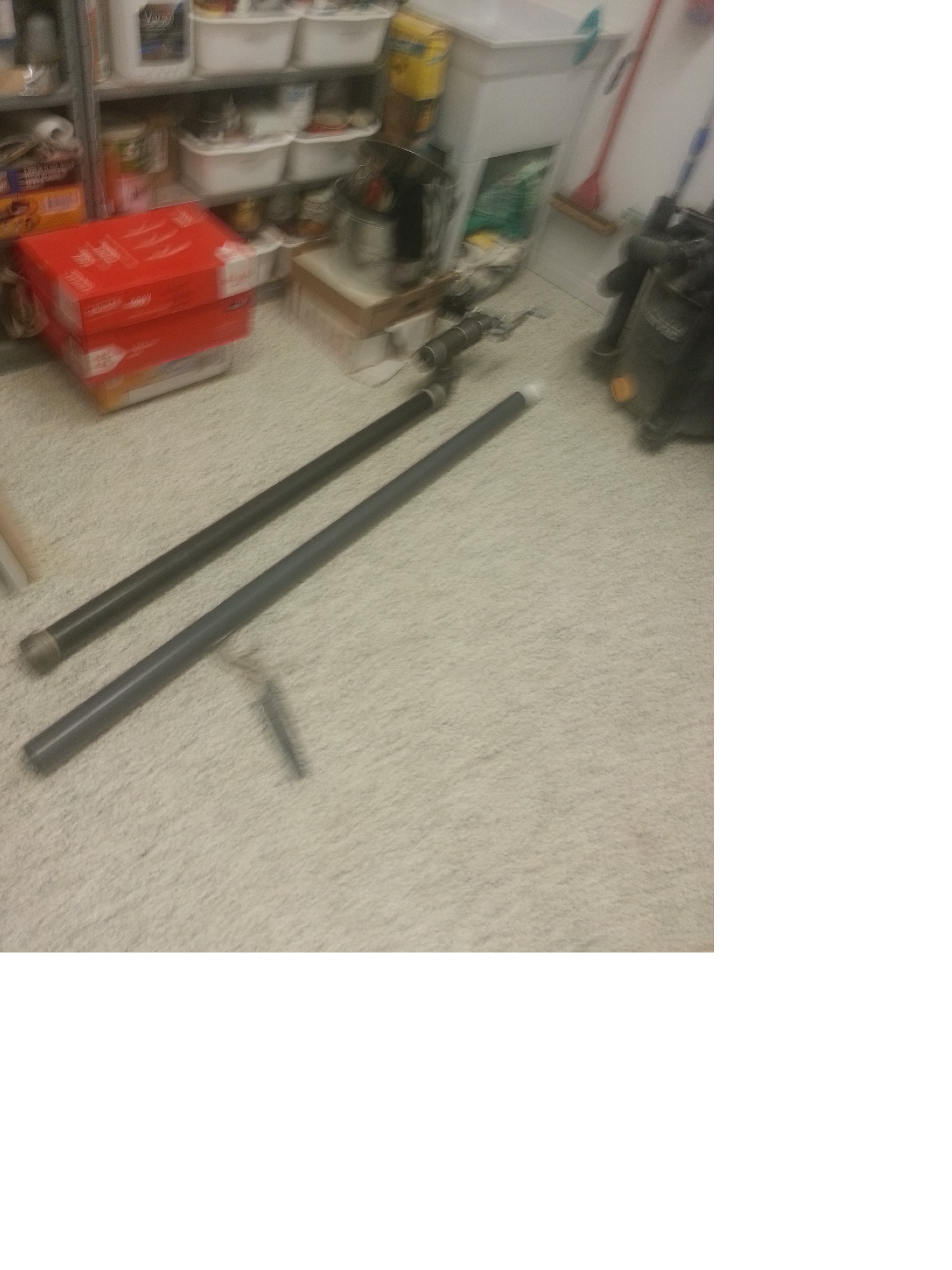

Here's the smaller cannon. It's got a .5" copper barrel, great for marbles, batteries and homemade darts. Will probably be ordering some ball bearings as well.
.5" cannon
.5" cannon

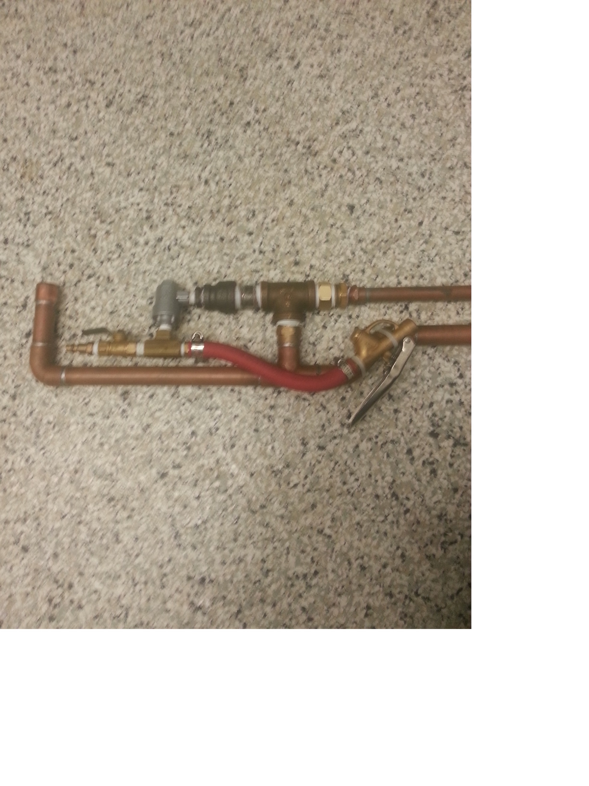

The qev is probably overkill for the pilot, but with the length of hose I have I figured I'd be losing efficiency with just a blow gun pilot.
Filling/pilot/piston housing

It seems like the sprinkler valve top is leaking as I get past 50psi, a result of a weak top and cheap epoxy. I'm thinking one of two options...
1-lather on the rest of the epoxy I have over the top of the valve
Probably worth trying even if it is a waste of epoxy
2-move the qev from the smaller cannon to the bigger one
I have a 2"x1/4" reducing bushing kicking around so I could keep the pilot volume for the qev pretty small, but would I be losing too much efficiency in doing so?
Eliminating the sprinkler valve would up the max pressure for the set-up, but I'm mostly wondering if my qev solution will work, and at the same time I'd probably have to totally change the smaller cannon to be blow gun operated.
Thanks!!!
Mon Mar 03, 2014 4:50 pm
Trauts wrote:I'm mostly wondering if my qev solution will work
Short answer is yes, you have an o-ringed piston so a super high flow pilot is not critical.
