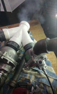

I'm building my cannon with 2 asco valves(1.5 in.) and 1 goyen valve (1.5 in.). Pictures attached:
The 2 hoses coming from the "horns" to the body are just part of the chamber. 3 hoses coming from 1/8 pilot ports of the 3 valves to a tee. One hose comes from the tee to the 1/4 ball valve as the trigger. I have a loud leak coming from the 3/8 exhaust port of the left asco valve (picture) and maybe some other places but right now that spot is the most obvious :cry: . I think the valve is defective but before taking apart or do anything stupid I need the pro's opinions.

Use something like bubble magic with a brush or spray bottle to coat the joints and connections and look for bubbles.
Stopping all the little combined leaks may indeed solve your valve issue. Some valve's will have the tendency to be harder to seal, more so when new. Stopping the leaks may give the extra pressure needed to seal the valve.

Sometimes not filling fast enough causes leaks but this would be coming out of the barrel end, I'd wager it's more likely that your diaphragm is damaged or needs cleaning.

So I checked for leaks...Only that spot is my problem. So I opened that one up and the one on the right. I discovered that the leaky one's missing a spring on top of the pilot diaphragm. They both have no spring on the main diaphragm though...I already ordered parts...hopefully that will fix the problem. I'm going to fill the chamber with a pcp pump...Do you guys think it will be good/fast enough to seal my valves.
