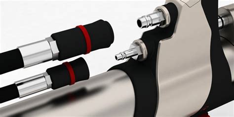

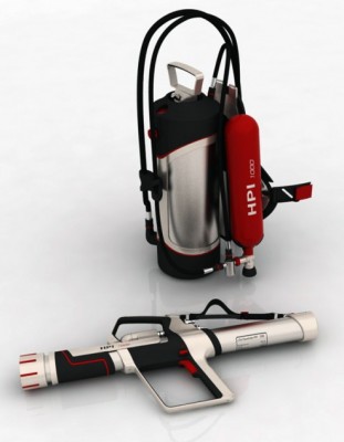

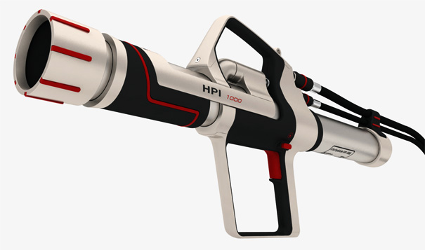

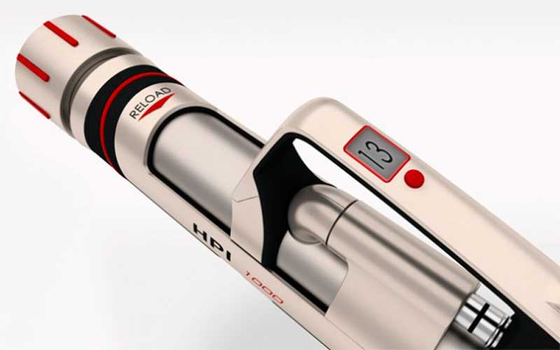

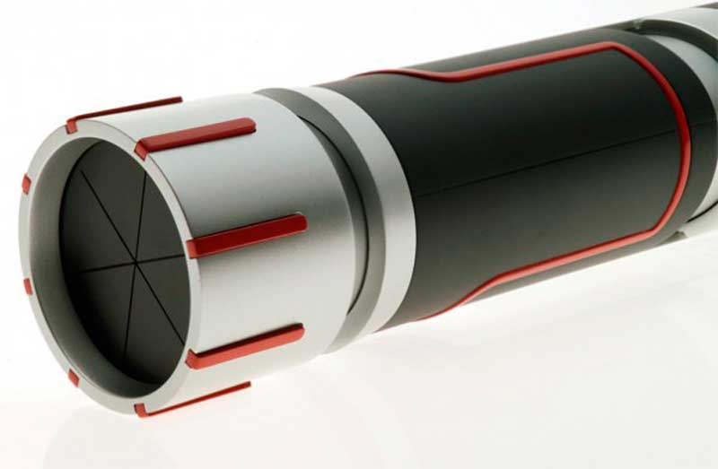

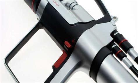

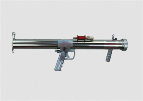

ok so i guess the IFEX 3000 site is down it was hard for me to find the newest one is called the HPI 1000 i will post some pics and a link to YouTube showing them working to show why its air cannon related for sure as it shoots a small atomized mist of water around 400kph or 248.54MPH and yes it is now being used in some places as a riot control weapon
on the rv pumps i have messed with many of them in ranged from 35-100psi output they have a pressure valve switch that keeps there output line to said pressure and then turning off even when powered i made many backpack sprayers from them they are awesome but this is a little different as you will see in the pics and video link

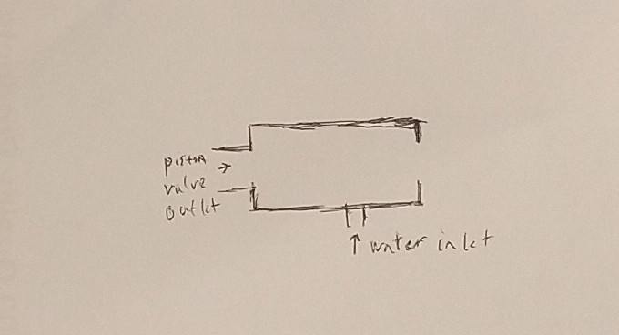

Oh wow that's very different from what I guessed.
It looks like a regular pneumatic cannon but it lets water in the barrel, it seems like they even aim it up to prevent the water from spilling out between shots.

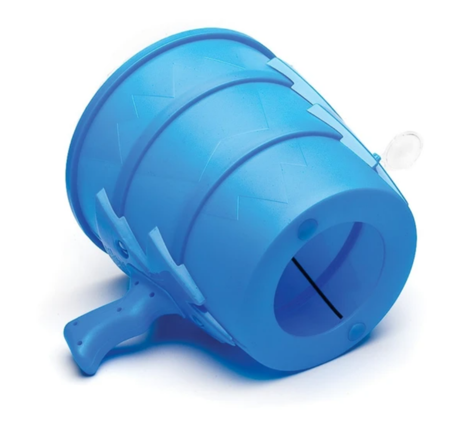

Besides making a fast opening cannon, put something on the muzzle to help create a vortex would help kinda like you see on airzooka toys, the product you showed constricts air towards the center with the rubber flaps but a rigid cap with a hole could achieve a similar effect.
You could make something operations at PVC pressures but to get the same effect I think you need a few hundred psi
