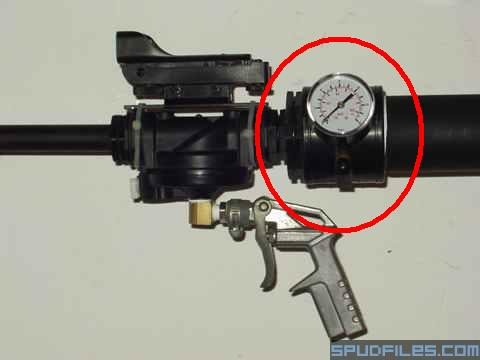

first off this isnt my gun, im gonna try to
replicate this gun but i cant seem to figure
out how to attach the pressure gauge and
the schrader valve to the 2" coupling
does anyone know how to do this?
how do you do this

sorry im new at this
but ill try to understand
i have to drill a hole in the coupling
and attach the dread connector
right?
or wrong?

Yes. Say its a 1/8" brass nipple on the gauge, you would drill about a 7/64" hole?(I use metric,so whats the next size down from 1/8"?)
Anyway the point is you drill a smaller hole then the thread is. Then you get a 1/8" tap and thread the hole. You then wrap teflon around the threads of the gauge and screw it carefully(and straight) into the hole.
This is really simple stuff. Make sure you do alot of searching before making a pneumatic and asking basic questions. We don't want you to get hurt.

yea now i get you
this is my first pneumatic
i pretty much have all the facts down
ive done a bunch of research
i cant seem to find an answer to some stuff
like whats the schrader valve for?
sorry if the question sounds dumb
i just have to know before i actually make it
or else i cant make it
EDIT:never mind my basic knowledge of
biking kicked in and i know what its for now
haha

Yeah, Ofcourse I do, Thats why I asked what the next size down from 1/8" is. I know the metric I.D's and O.D's of brass fittings up to 25mm but putting it into imperial is difficult as.....SpudBlaster15 wrote:Crowley, Crowley, Crowley...MrCrowley wrote:Yes. Say its a 1/8" brass nipple on the gauge, you would drill about a 7/64" hole?(I use metric,so whats the next size down from 1/8"?).
You do know that pipe thread sizes are completely independant of standard measurments, right?
Chances are, the gauge has either a 1/8" NPT or 1/4" NPT thread. The former would require a "Q" drill bit, and the later a 7/16" drill bit.
Fraudready, a schrader valve is used as means of pressurizing the chamber with a compressed gas, usually air.
1/4" = 6mm
1/2" = 12mm
3/4" = 18mm
1" = 24mm
But our alternatives for those sizes are:
8mm(Equiv of 1/4")
15mm(Equiv of 1/2")
20mm(Equiv of 3/4")
25mm(Equiv of 1")
See how they are 2mm out on most of them. I wasn't sure if your threaded nipples ect are the same because of that weird conversion.
