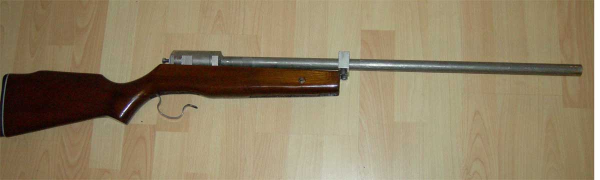

Here is a mock-up of how its going to look with a rifle stock from a BB gun. I am also going to insulate the barrel and add a lexan shield to prevent any contact with the high voltage parts.
I am not planing to do any full power shots when i am holding it in my hands and will take the necessary safety precautions so it will be relatively safe.
- Mock-up of the handheld ETG.
- ETG_test.jpg (22.71 KiB) Viewed 5673 times

I hope for you you dont vaporize, ehm... I mean shock yourself.
