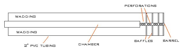

My suggestion would be to drill holes in the exposed section of barrel, then sleeve the whole barrel+chamber with 2" or larger PVC (it can be DWV in this case) and maybe add a few baffles around the perforated barrel section. The baffles can be cut from thin ply or balsa wood and fixed in place with araldite.

jackssmirkingrevenge wrote:My suggestion would be to drill holes in the exposed section of barrel, then sleeve the whole barrel+chamber with 2" or larger PVC (it can be DWV in this case) and maybe add a few baffles around the perforated barrel section. The baffles can be cut from thin ply or balsa wood and fixed in place with araldite.
Just make sure to clean out the inside of the barrel after you drill the holes, you might get some debris in there that would jam your projectile. Jack's idea would do you well for a silencer.

paaiyan wrote:Just make sure to clean out the inside of the barrel after you drill the holes, you might get some debris in there that would jam your projectile.
I took that for granted but thanks for mentioning it :) this way, you get a silencer without adding any length to your barrel or too much extra weight, and the longer you make the outer PVC tubing the more effective it will be.
Well I've worked with... well... stupid people long enough that I feel I have to mention these things. It probably goes without saying, but the things people do when you don't warn them of the obvious...
