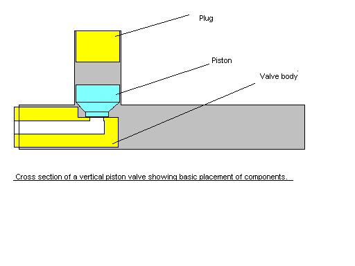

A diagram would be nice.

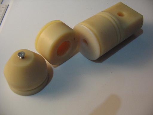

I have attached a pic of the layout of the basic components of a vertical piston valve and a pic of the nylon components before they were drilled and tapped.
I decided not to create a whole new thread on the vertical piston valve because it is very simple and straight forward. The advantage of a vertical piston valve is it allows the launchers design to be in-line, rather than coaxial or over and under.

hmmm.... inline piston valve....... might have to replace my sprinkler... lol
how do you cut and machine that stuff?

I have a contact that is teaching me basic machining, he was making the stuff while I watched and helped out.

so the vertical piston is basically a homebuilt sprinkler valve with a piston, i have seen someone do that before i think..

Well, sort of. It has the performance of piston valve and a layout of a sprinkler valve.

But the small hole does contrict flow for larger barrels right? (Wich is OK for paintball but not okay for shooting trough random junk.

Yep, I would say it does. The higher pressure makes up for it. Not that the flow is bad though, it is better than you think. Of course for a better design you could make the valve higher flowing.

So
Or just use a small barrel, not any larger then the porting.
Or build a larger valve with a larger porting to fire a large barrel at full power.
