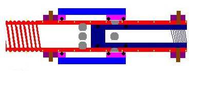

this thing does pwmn man i'm trying to make 1 my self buth a litle diferend, i will try to make it witout the stock my gun wil have a longer barel ore a shorter size.
thnx for the disign of the valve it realy helped me out
buth what is the size of the red part on the slide valve? and is it posible to give it in mili meters?? because i'm from holland and hir we don't use inches
btw this is my design (olmost the same as the one of clide buth 1 diferend
i think it is 32mm (i gues its 1.5 inch) buth i don't know it for shure.
what is the size in milimeter of the red part???
paintball 2.JPG (10.88 KiB) Viewed 10555 times
