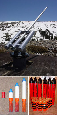

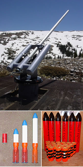

What you have made is basically a manaully operated "Parsoneault" valve... the valve used in avalaunchers and pneumatic pitching machines...

http://avalanchemitigationservices.com/ ... lution.pdf
you won't get diagrams and such unless you do a patent search, I'll attach the patent pdf in a few minutes...

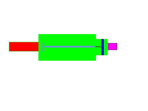

After doing some number crunching and research, one of the main reasons your QDV opens so quickly is because the closer the sealing face is( in your case the forward o ring) to the piston diameter(in this case the rearward o ring) the faster the valve will actuate, Rag or another vet can prolly cite the actual nomenclature... Your flow rates are similar to burst disc and toolie designs because of the direct airflow path from chamber to barrel, and some may argue but I think sometimes in a pneumatic a toolie or design such as yours will perform better thatn a burst disc because a burstdisc the pressurized air is overcoming an obstruction to begin the flow, where as a piston valve on opening creates a momentary vacuum that allows the pressurized air to accelerate before slamming into the projectile( but a non toolie piston creates flow restriction and turbulance after the initial opening, decreasing their performance)...
If you look at this modified toolie diagram, the smaller you can make the piston on the pilot side, the faster the valve will open...
and you could actually make your piston with a sealing face for the barrel, and totally remove all the materiel between the ports and it would still work, as long as the piston "tube" is stabile...
I thought this too and it is true as it moves from an air piloted valve into the realm of a QEV. Continuing in GGDT trying to model my valve (GGDT won't permit a seat = piston diameter) I started getting the ratio very close to 1:1 in size. As you approach a QDV, the time in GGDT start to increase again due to the very slow initial acceleration force. The slow acceleration causes a slow valve opening limiting acceleration.... An impact start gets it way past this slow start portion of the curve directly into the power accelleration zone. A good project would be to find the best diameter to seat ratio for a fast piston QEV.
To see this extreme, model a 2.1 inch piston with a 2.0 inch valve seat in GGDT. I did this trying to model my valve.

But I guess you're starting to see why the piston/sealing face ratio effects openingg speed greatly...

To sum up after ignoring 90% of the patent diagram which is in fact irrelevant:
A Parsoneault valve is the spool valve piston you have there, using o-rings either side of the chamber port.
The major differences are:
1) It has the piston secured by means of a spring to prevent the piston from moving until fired
2) Firing is achieved by pulling back the piston with air pressure.
Other than that all is effectively the same.
The rest of the patent mainly covers a throttling device to limit the gas flow into the barrel... which we're not really interested in... (why would we want to limit flow here?).
It's a new valve for the spudgun library but not for the world.
Heck, no spudgun valve is unique, best to hope for is to be first to claim it for spudgunning :)
Speaking of avalanche launchers, there's a variation of Tech's deisgn uses the projectile as the "valve", as in this patent.

I've coloured the patent diagram to make it much easier to follow, click for full scale:
Pipe #20 fills the chamber.
Pipe #32 fires the valve by allowing air pressure to overcome the spring
It's the same balanced spool valve your design is and as I said the only difference is that it uses (essentially) a pneumatic ram to unbalance the piston.

Thanks for finding a diagram. It's the first one I have seen. 3 o rings and what looks like a pop off valve in the outlet air stream (maybe the pitch speed regulator). The main valve does look like mine, but much smaller aperture in relation to the barrel. It is very long. It does not have a mechanical decoupling from the trigger to the main valve to reduce the mass being accelerated.
That valve while reasonably fast suffers from excess length (mass) and small diameter (flow). The 3rd section with an o ring doesn't help the friction. The pop-off in the outlet doesn't help flow, but may help with the opening force to compensate for the excess mass and small aperture.
Again, thanks for finding the photo of the valve and adding the color.
